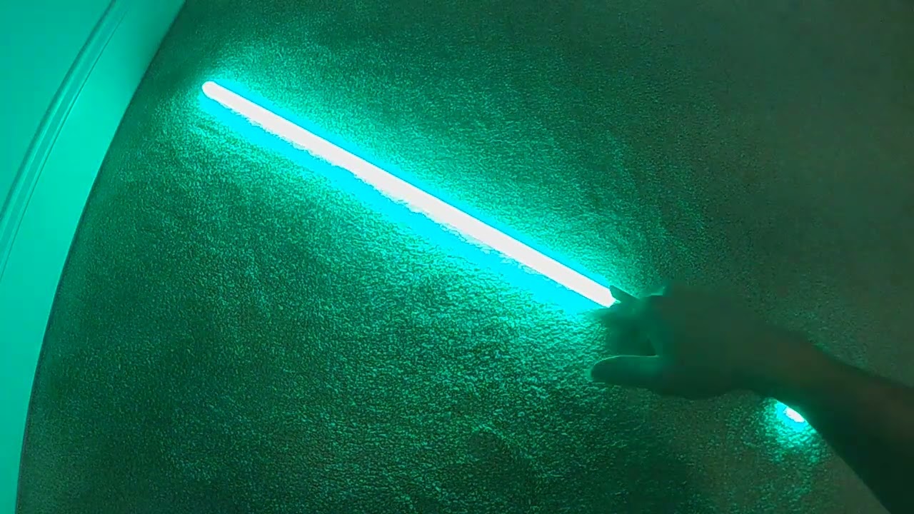

I’ve been working with @profezzorn to address the false clashes from speaker vibrations and we have a potential solution but need more testing.
I didn’t actually have any sabers that exhibit this behavior but I was able to replicate by leaving the bottom half of a hilt off and lowering the CLASH_THRESHOLD_G for one of my sabers so I used it to test.  Now we need to have users who’ve actually had this issue to help test and prove it out.

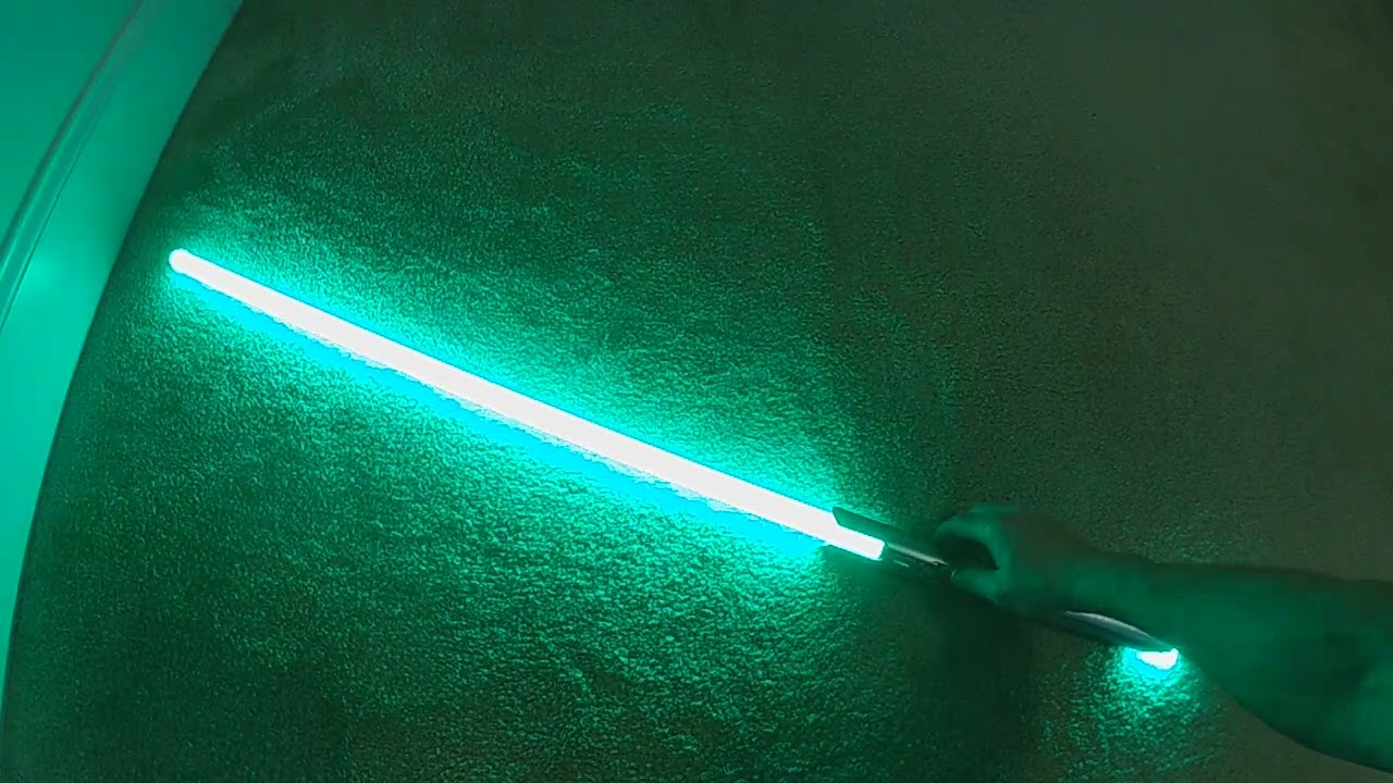

Baseline:
POC (Test 1):
