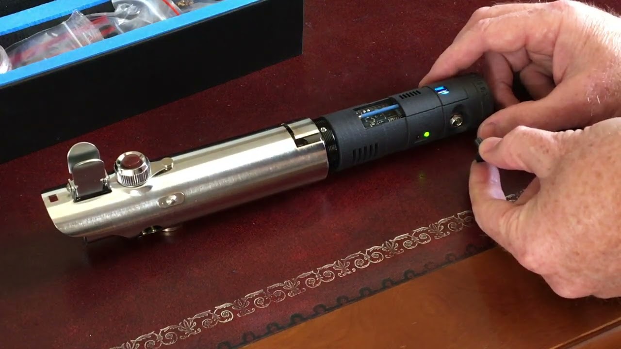

Sorry to say, I have just experienced the dreaded SD card error on a board loaded with OS 5.9.
Board is a brand new KR Sabers with the supplied SD card. SDtest in serial monitor gave good speed figures.
Here’s a vid:

If you wait a second or two after “not found” does it work anyway?
No. I just tried it and got almost 20 clean boots before it threw the error. But when it did and I lit the blade there was no sound.
Worth trying 4.8?
What if you go to next preset regardless of the initial spoken “not found” errors?
Does it “kick in” then and work fine?
Just tried it - this time I got the error on the first attempt!
Tried switching fonts and it just repeated the error each time I did so.
It also didn’t save the state I left it in. i.e. I switched to the third font before re-inserting the kill key, but when I booted up again, it was back on the first font. So it seems the lady isn’t lying - she really can’t see the SD card - until you re-power when she finds it again.
So weird.
