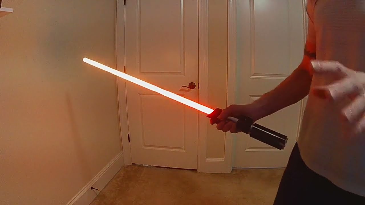

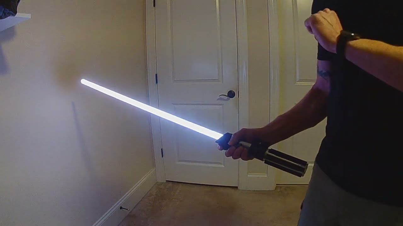

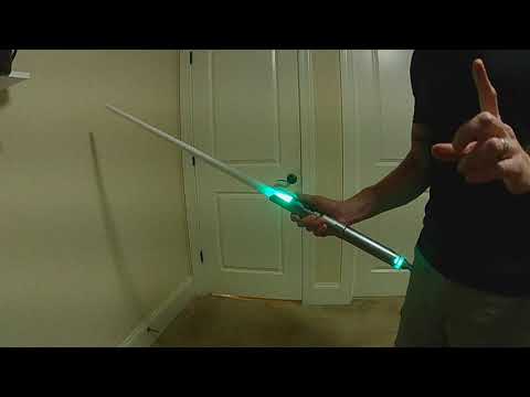

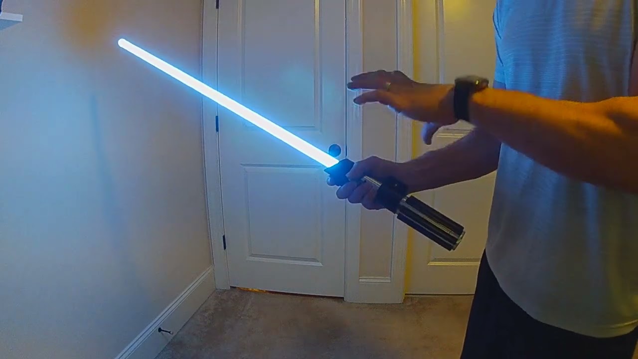

Here are some demos I’ve shot so far but there are many more uses.
Alt Font can be used with Kyber Select styles to allow the change in color/effect to also align to a specific “alt” folder in your current font.
Alt Font can be used with ColorSelect<> styles for Dual Phase or Multi Phase blades so each color/effect aligns to a specific “alt” folder.
Alt Font can also be used with “interactive” styles to create “states” in your blade styles that not only change how the blade looks but how it sounds for a temporary or toggled effect
