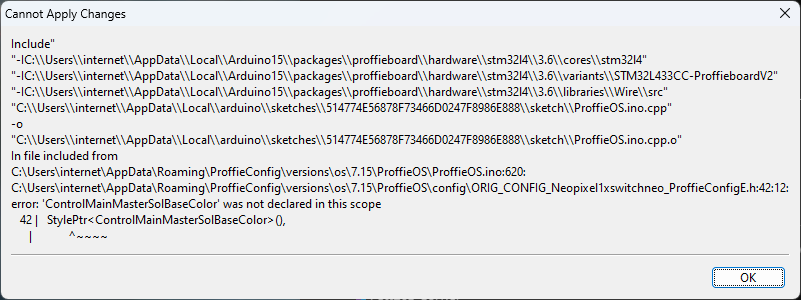

Don’t look like GitHub - ryancog/ProffieConfig: The All-In-One Proffieboard Management Utility for macOS and Windows! keeps the use lines …
using ControlMainMasterSolBaseColor = Layers<AudioFlicker<Stripes<22000,-1400,RgbArg<BASE_COLOR_ARG,Rgb<0,0,255>>,RgbArg<BASE_COLOR_ARG,Rgb<0,0,255>>,Mix<Int<10000>,Black,RgbArg<BASE_COLOR_ARG,Rgb<0,0,255>>>,RgbArg<BASE_COLOR_ARG,Rgb<0,0,255>>,Mix<Int<18000>,Black,RgbArg<BASE_COLOR_ARG,Rgb<0,0,255>>>>,RgbArg<BASE_COLOR_ARG,Rgb<0,0,255>>>,TransitionEffectL<TrWaveX<RgbArg<BLAST_COLOR_ARG,Rgb<255,255,255>>,Scale<EffectRandomF<EFFECT_BLAST>,Int<100>,Int<400>>,Int<100>,Scale<EffectPosition<EFFECT_BLAST>,Int<100>,Int<400>>,Scale<EffectPosition<EFFECT_BLAST>,Int<28000>,Int<8000>>>,EFFECT_BLAST>,Mix<IsLessThan<ClashImpactF<>,Int<26000>>,TransitionEffectL<TrConcat<TrInstant,AlphaL<RgbArg<CLASH_COLOR_ARG,Rgb<255,255,255>>,Bump<Scale<BladeAngle<>,Scale<BladeAngle<0,16000>,Sum<IntArg<LOCKUP_POSITION_ARG,16000>,Int<-12000>>,Sum<IntArg<LOCKUP_POSITION_ARG,16000>,Int<10000>>>,Sum<IntArg<LOCKUP_POSITION_ARG,16000>,Int<-10000>>>,Scale<ClashImpactF<>,Int<12000>,Int<60000>>>>,TrFadeX<Scale<ClashImpactF<>,Int<200>,Int<400>>>>,EFFECT_CLASH>,TransitionEffectL<TrWaveX<RgbArg<CLASH_COLOR_ARG,Rgb<255,255,255>>,Scale<ClashImpactF<>,Int<100>,Int<400>>,Int<100>,Scale<ClashImpactF<>,Int<100>,Int<400>>,Scale<BladeAngle<>,Scale<BladeAngle<0,16000>,Sum<IntArg<LOCKUP_POSITION_ARG,16000>,Int<-12000>>,Sum<IntArg<LOCKUP_POSITION_ARG,16000>,Int<10000>>>,Sum<IntArg<LOCKUP_POSITION_ARG,16000>,Int<-10000>>>>,EFFECT_CLASH>>,LockupTrL<TransitionEffect<AlphaL<AlphaMixL<Bump<Scale<BladeAngle<>,Scale<BladeAngle<0,16000>,Sum<IntArg<LOCKUP_POSITION_ARG,16000>,Int<-12000>>,Sum<IntArg<LOCKUP_POSITION_ARG,16000>,Int<10000>>>,Sum<IntArg<LOCKUP_POSITION_ARG,16000>,Int<-10000>>>,Scale<SwingSpeed<100>,Int<14000>,Int<22000>>>,AudioFlicker<RgbArg<LOCKUP_COLOR_ARG,Rgb<255,255,255>>,Mix<Int<12000>,Black,RgbArg<LOCKUP_COLOR_ARG,Rgb<255,255,255>>>>,BrownNoiseFlicker<RgbArg<LOCKUP_COLOR_ARG,Rgb<255,255,255>>,Mix<Int<12000>,Black,RgbArg<LOCKUP_COLOR_ARG,Rgb<255,255,255>>>,300>>,Bump<Scale<BladeAngle<>,Scale<BladeAngle<0,16000>,Sum<IntArg<LOCKUP_POSITION_ARG,16000>,Int<-12000>>,Sum<IntArg<LOCKUP_POSITION_ARG,16000>,Int<10000>>>,Sum<IntArg<LOCKUP_POSITION_ARG,16000>,Int<-10000>>>,Scale<SwingSpeed<100>,Int<14000>,Int<22000>>>>,AlphaL<AudioFlicker<RgbArg<LOCKUP_COLOR_ARG,Rgb<255,255,255>>,Mix<Int<20000>,Black,RgbArg<LOCKUP_COLOR_ARG,Rgb<255,255,255>>>>,Bump<Scale<BladeAngle<>,Scale<BladeAngle<0,16000>,Sum<IntArg<LOCKUP_POSITION_ARG,16000>,Int<-12000>>,Sum<IntArg<LOCKUP_POSITION_ARG,16000>,Int<10000>>>,Sum<IntArg<LOCKUP_POSITION_ARG,16000>,Int<-10000>>>,Scale<SwingSpeed<100>,Int<14000>,Int<18000>>>>,TrExtend<5000,TrInstant>,TrFade<5000>,EFFECT_LOCKUP_BEGIN>,TrConcat<TrJoin<TrDelay<50>,TrInstant>,Mix<IsLessThan<ClashImpactF<>,Int<26000>>,RgbArg<LOCKUP_COLOR_ARG,Rgb<255,255,255>>,AlphaL<RgbArg<LOCKUP_COLOR_ARG,Rgb<255,255,255>>,Bump<Scale<BladeAngle<>,Scale<BladeAngle<0,16000>,Sum<IntArg<LOCKUP_POSITION_ARG,16000>,Int<-12000>>,Sum<IntArg<LOCKUP_POSITION_ARG,16000>,Int<10000>>>,Sum<IntArg<LOCKUP_POSITION_ARG,16000>,Int<-10000>>>,Scale<ClashImpactF<>,Int<20000>,Int<60000>>>>>,TrFade<300>>,TrConcat<TrInstant,RgbArg<LOCKUP_COLOR_ARG,Rgb<255,255,255>>,TrFade<400>>,SaberBase::LOCKUP_NORMAL,Int<1>>,ResponsiveLightningBlockL<Strobe<RgbArg<LB_COLOR_ARG,Rgb<255,255,255>>,AudioFlicker<RgbArg<LB_COLOR_ARG,Rgb<255,255,255>>,Blue>,50,1>,TrConcat<TrExtend<200,TrInstant>,AlphaL<RgbArg<LB_COLOR_ARG,Rgb<255,255,255>>,Bump<Scale<BladeAngle<>,Int<10000>,Int<21000>>,Int<10000>>>,TrFade<200>>,TrConcat<TrInstant,RgbArg<LB_COLOR_ARG,Rgb<255,255,255>>,TrFade<400>>,Int<1>>,LockupTrL<AlphaL<TransitionEffect<RandomPerLEDFlickerL<RgbArg<DRAG_COLOR_ARG,Rgb<255,255,255>>>,BrownNoiseFlickerL<RgbArg<DRAG_COLOR_ARG,Rgb<255,255,255>>,Int<300>>,TrExtend<4000,TrInstant>,TrFade<4000>,EFFECT_DRAG_BEGIN>,SmoothStep<Scale<TwistAngle<>,IntArg<DRAG_SIZE_ARG,28000>,Int<30000>>,Int<3000>>>,TrWipeIn<200>,TrWipe<200>,SaberBase::LOCKUP_DRAG,Int<1>>,LockupTrL<AlphaL<Stripes<2000,4000,Mix<TwistAngle<>,RgbArg<STAB_COLOR_ARG,Rgb<255,68,0>>,RotateColorsX<Int<3000>,RgbArg<STAB_COLOR_ARG,Rgb<255,68,0>>>>,Mix<Sin<Int<50>>,Black,Mix<TwistAngle<>,RgbArg<STAB_COLOR_ARG,Rgb<255,68,0>>,RotateColorsX<Int<3000>,RgbArg<STAB_COLOR_ARG,Rgb<255,68,0>>>>>,Mix<Int<4096>,Black,Mix<TwistAngle<>,RgbArg<STAB_COLOR_ARG,Rgb<255,68,0>>,RotateColorsX<Int<3000>,RgbArg<STAB_COLOR_ARG,Rgb<255,68,0>>>>>>,SmoothStep<Scale<TwistAngle<>,IntArg<MELT_SIZE_ARG,28000>,Int<30000>>,Int<3000>>>,TrConcat<TrExtend<4000,TrWipeIn<200>>,AlphaL<HumpFlicker<Mix<TwistAngle<>,RgbArg<STAB_COLOR_ARG,Rgb<255,68,0>>,RotateColorsX<Int<3000>,RgbArg<STAB_COLOR_ARG,Rgb<255,68,0>>>>,RotateColorsX<Int<3000>,Mix<TwistAngle<>,RgbArg<STAB_COLOR_ARG,Rgb<255,68,0>>,RotateColorsX<Int<3000>,RgbArg<STAB_COLOR_ARG,Rgb<255,68,0>>>>>,100>,SmoothStep<Scale<TwistAngle<>,IntArg<MELT_SIZE_ARG,28000>,Int<30000>>,Int<3000>>>,TrFade<4000>>,TrWipe<200>,SaberBase::LOCKUP_MELT,Int<1>>,InOutTrL<TrWipeX<BendTimePowInvX<IgnitionTime<300>,Mult<IntArg<IGNITION_OPTION2_ARG,10992>,Int<98304>>>>,TrWipeInX<BendTimePowX<RetractionTime<0>,Mult<IntArg<RETRACTION_OPTION2_ARG,10992>,Int<98304>>>>,Black>>;
It should extract them out and place them into the styles.
It won’t keep them separate, but it should keep them compilable.
If that’s not happening, please open an issue on GitHub with the example config and your log file and I can take a look. I don’t want to hijack Fett’s thread.
