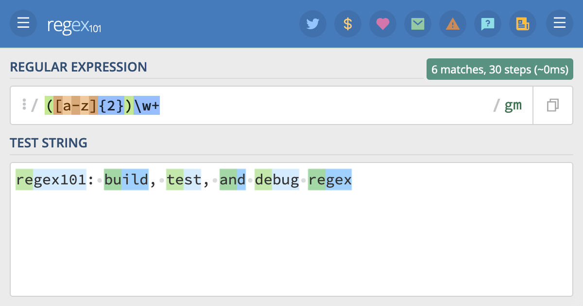

I tried running it on the following site for testing purposes:
For Bash I used this:
With the Tutorial from here:
And found a stackoverflow topic, that stated BASH_REMATCH, is platform-dependent.
Not sure how this can be included in an if statement.
Found something:
This seems to work:
