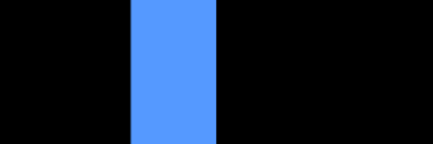

I tried to put 30px into a 10(cm) blade which is in turn only 1/11th of a circle.
Those inputs where far from reality, so the image is the same. Not sure though if sarcasm or not :wink:
I was trying different extremes of inputs.
Imagine what I can do with 999, 1, 99 (well this would probably be a blue line)

  • I would change alert message for question 1 to
    • “! Minimum amount of pixels is X, try again”
    • personally I would recommend doing X = 30, but open to debate
  • :warning: $ calc_len seems to not be working correctly
    • anytopnm shadowfoil.png | ./pnmwindshieldwiper --height=133 --length= --offset=15 | pnmscale -reduce 10 | ./pnmtorle >../styles/shadowfoil_133_FC_POV_data.h
    • –length parameter is empty
    • script runs but leads to this image:
      shadowfoil_133_preview
    • okay, now I know why, you didn’t write that code yet.
      • Math should be
        round($height * 100 / 144) → length in cm. if you further devide by 2.54 (before rounding) you have your inches. But rounding to the next full inch is more of a delta than rounding to the next cm, so we would be more exact to use the metric system.
… to be continued
Cool, updated the minimum message and added calc_len math.
