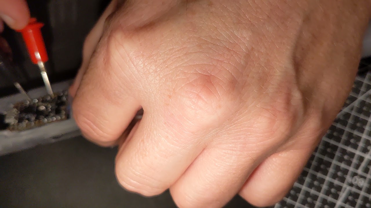

Suddenly, my blade detect is not working.
Currently, GND and Data4 pin register properly on a meter, beeping with blade inserted, no beep when removed when the board has no power. However, when power is applied, the pads beep continuity constantly, regardless of blade.
Thoughts?
I reverted to a ProffieOS archive folder of mine from July. Same results.
So what actually happens?
Does it register as if the blade is always inserted? Or always not inserted?
Always inserted. Grounded.
Now check this out:
Maybe I’m missing something.
Here’s the Blade Detect thing:
Instead of measuring resistance, can you try measuring voltage between GND and Data3 while on?
AC fluctuating btw .069 and .082
DC fluctuating btw .034 and .040
Both GND pads same
That means that it’s constantly low.
Either something is shorted to it, or the pullup resistor isn’t working anymore.
If it’s the pullup resistor, the solution would be to use another pad for blade detect. That could also be the solution if it’s shorted somehow.
Sorry. blade detect is data 4. Solid 3.03vDC on that. Pin 3 was just the weird continuity example . GNDs were inconsistent etc…
But for blade detect, it is data 4 and I’ll stick to that for troubleshooting.
Now…with nothing changed except fixing my blade 3 LED strip (first pixel seems to have died) it’s not beeping at all with blade in / blade out while no power.
It DOES beep/no beep with power applied. Yet no blade detect triggered.
When the blade is running, inserting/removing does a very short blip of beep if any.
You really can’t test continuity when things are running, it doesn’t yield meaningful results. You also cannot measure resistance when it’s running. Basically only voltage measurements works while things are running.
Well, something must be wrong with data4. I moved blade detect to pin 10 and all is good again.
Back to blades troubleshooting.

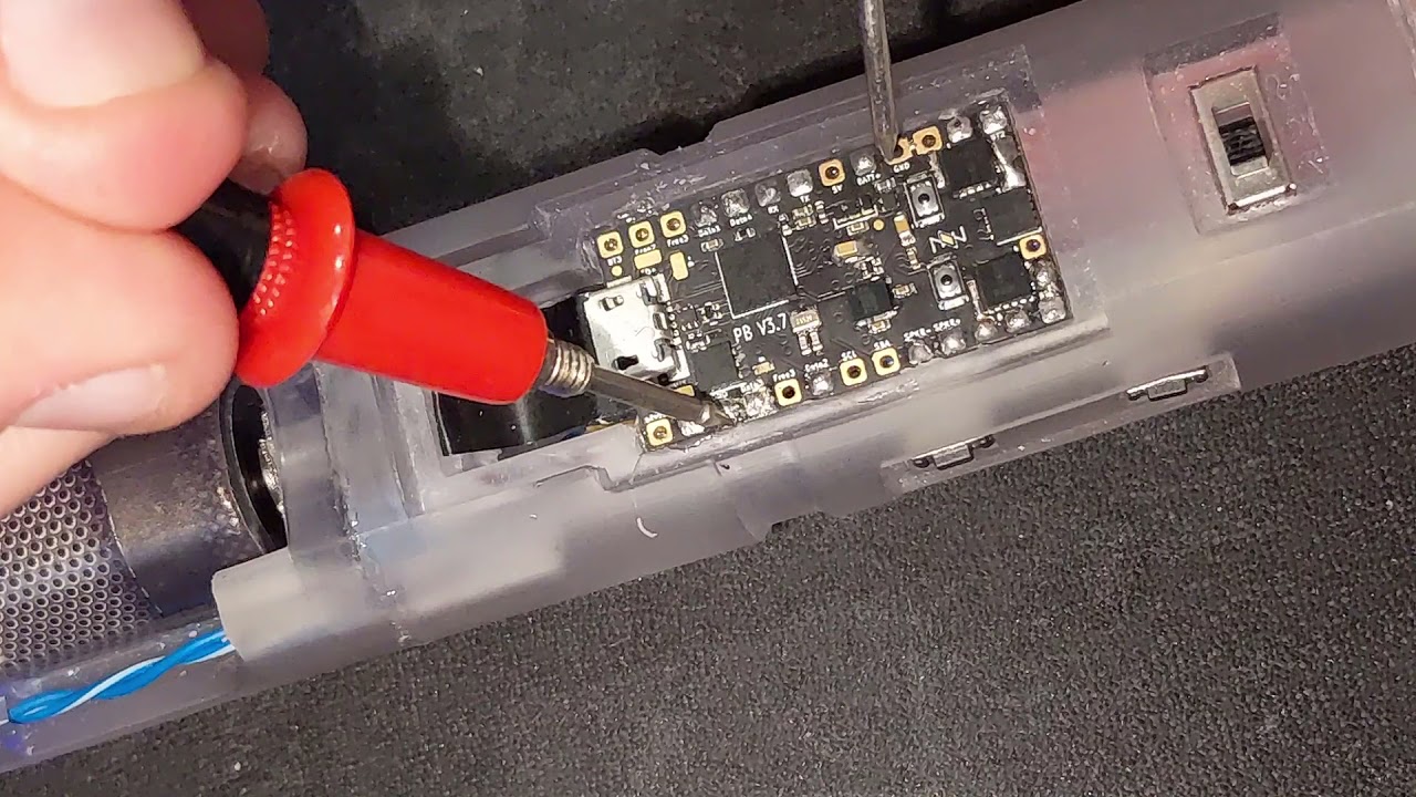

I was fiddling with my V3 prototype, and I discovered that the USB circuit wouldn’t go to sleep.
I discovered that the VUSB pad had 2.5 volts on it for some reason.
I’m hoping that this is a manufacturing defect in my prototype, and not some deeper problem.
If any of you guys have a V3 prototype that is still working, could you measure the voltage on VUSB when the board is NOT plugged in and tell me what it is?
Looks like 0.09 volts on mine although it’s tricky to make contact with that pad for me. Just battery power on the saber, while OFF if that mattered.
Excellent, thank you.
Any particular time to wait between readings to check for sleep?
