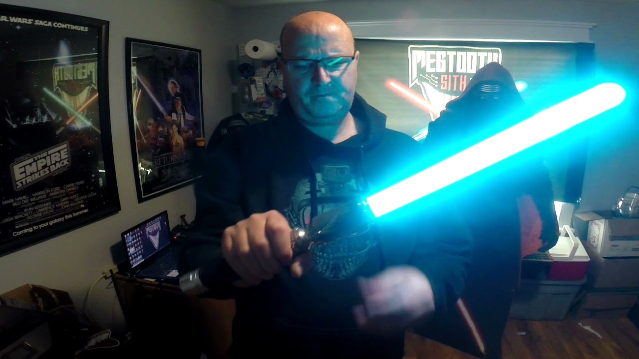

Im no photographer, nor do I have a decent camera, just my phone. But here is my beta 3.7 saber. Demo video uploading to the youtubes.
6 battery cycles, no glitches, saber functioning as expected. I have carried this saber with me everywhere. Work, errands, even a trip to the landfill! I really like the new higher read speeds on SD. Proffie already had a more organic feel in how it produced sound. In my opinion, the change to SDIO is THE greatest feature that differentiates this version from 1.5s and 2.2s. When we tested 2.2, it was for all intents and purpose an improved 1.5, with friendlier pads and a more dependable amp. Whereas the 3.7 is noticeably better than 1.5s and 2.2s.
While I havent tested OLED and other features, Id rate my experience with Proffieboard 3.7 as Excellent! This is an outstanding evolution for Proffie. As far as Im concerned, there is only one hurdle remaining to make 3.7 even better, and Im praying deep sleep will work. If it does, Proffieboard will be hard to beat once OS 6 drops!
Thanks Fredrik and to all the beta testers, and those helping to modify the ProffieOS.
