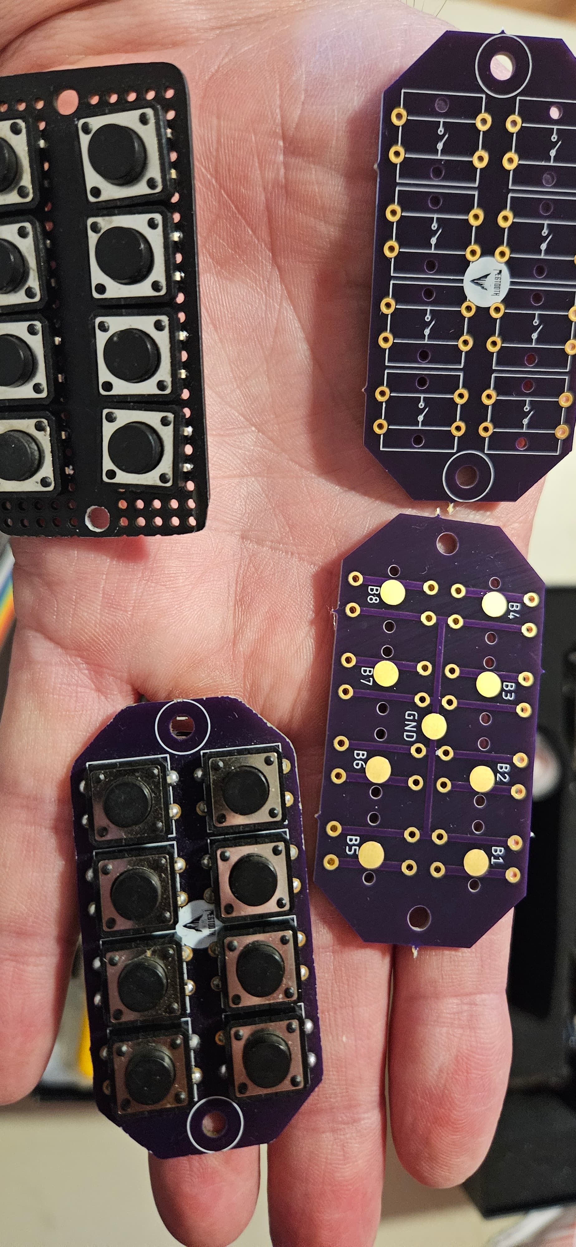

I started creating sound units a few months back. Using the adafruit board.
Am on FB - EngageSoundRig
Currently itās a 5 button device using some enclosed buttons that arenāt prone to the āsweatā elements. ![]()
Working on a custom PCB as a trigger board as I didnāt like the look of the micom one. Seems you are on a similar wavelength. ![]()
The version 2 has always intrigued me. Not necessarily from a āsellingā point of view but just how it all works. Iām new to this whole thing but love learning about the building and programming.

Iāll definitely move to an 8 button. Just need to wait for the latest revision of my PCB mounting board.
I guess with both of us testing on newer revision we can iron out any bugs sooner. ![]()
