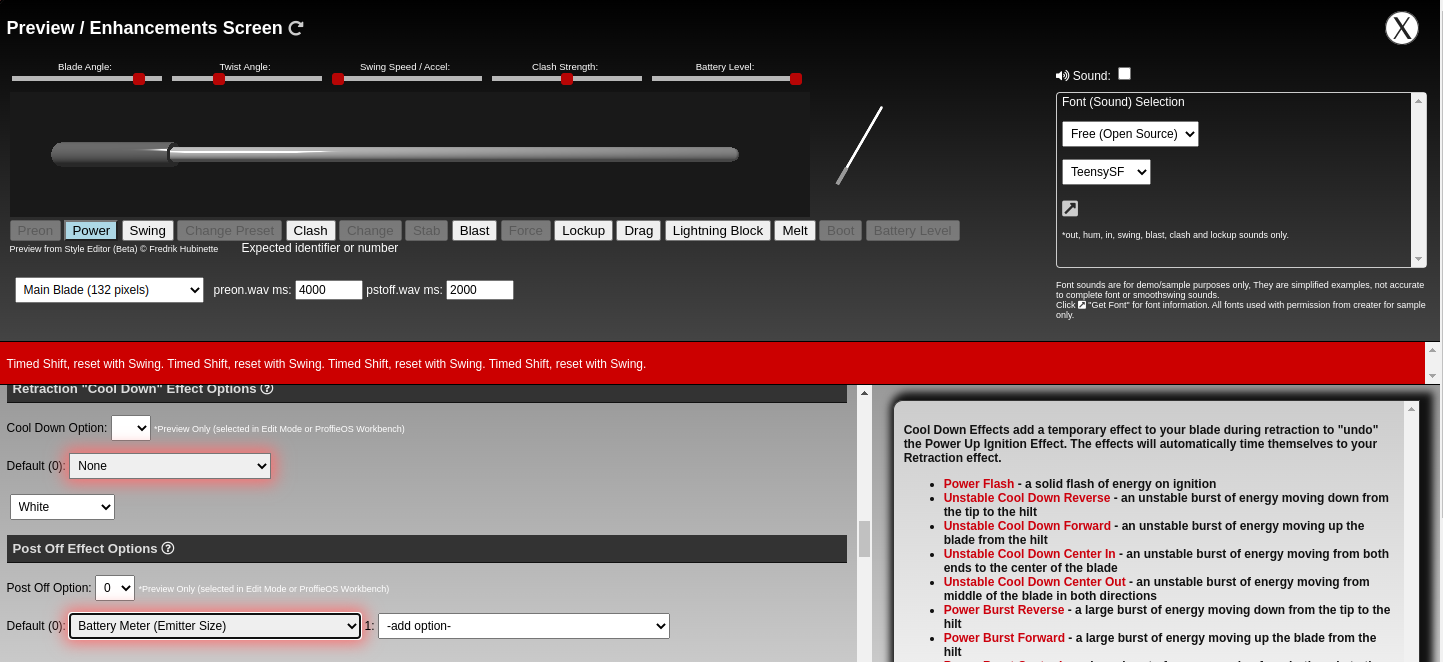

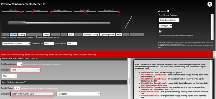

hey Fett263 I was playing around on the library and when I select the Battery Meter the power doesn’t work.
so it’s difficult to see the battery meter using the tool. this was reproducable regardless of the option it was on and also reproducable on both types of the Battery Meter.
