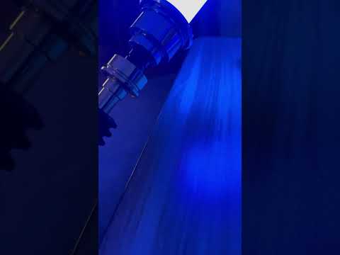

The idea of the clash I am talking about is basically this short video I am going to link here, except the clash speed matching the hits that I desire being about 2-4 time faster than what is shown in the video.
There’s a 1 millisecond “check” in my prop to allow Clash Strength to be calculated for “Real Clash” but I can’t imagine you’re able to clash your saber multiple times in less than a millisecond. There’s no “speed” on clashes, clash detection is based on the hit to your saber using CLASH_THRESHOLD_G to determine when a clash occurs. Outside of the addition of the 1 millisecond in the prop there’s nothing else that would delay the time between clashes that I can think of.

Yeah, I have a demonstration of what the clashes are like now that I have changed it.

But do you have a video of what it was like before? When it was slow?
I have an example of someone else demonstrating this earlier in the post named proffie clashes.
