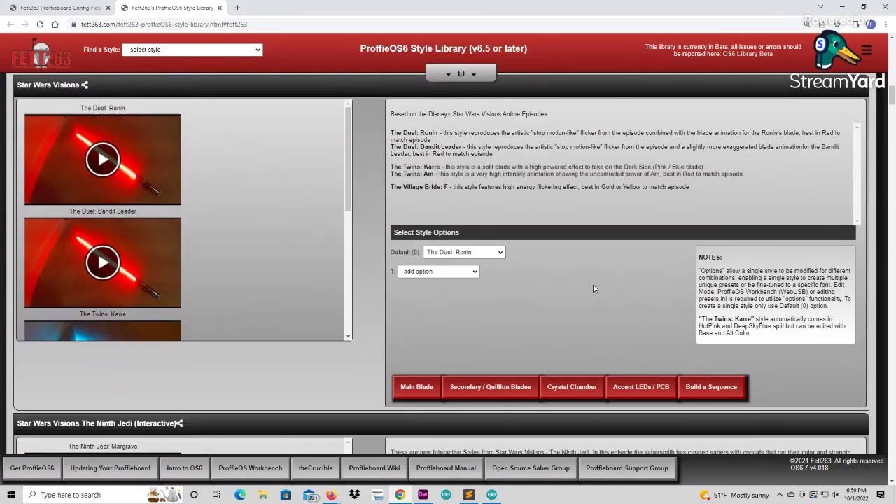

I’ve added a bunch more functionality to the Config Helper Tool to make customizing and updating your Proffieboard even easier.

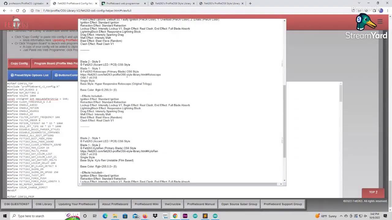

In addition, to walking through every define and option for our board and simplifying the Presets set up, v1.5 will now compile your config for use in Fredrik’s Web Programmer tool which allows you to Program your Proffieboard without Arduino (or you can generate a full config and upload through Arduino for those who prefer).
The Config Tool now also produces customized documentation based on your selections:
  • Style Options you’ve selected from the Library for editing and use.
  • Buttons and Controls based on the prop and defines
  • Supported Sound Files
    This will allow you to fully customize your saber AND get a custom “user manual” all in one place.
Try it out here: Fett263 Proffieboard Config Helper
