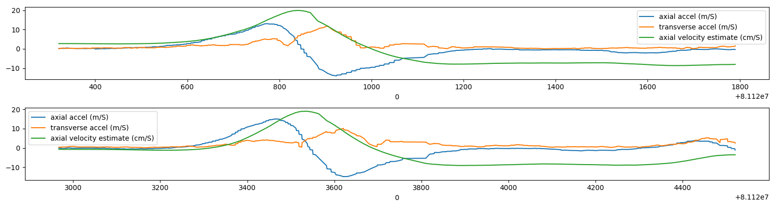

This gives me a pretty good velocity estimate - shown below is the telemetry where I stab forward (blue is axial accel, orange is axial velocity estimate)
Seems like I can just check for a velocity over some threshold (maybe 40?) to trigger thrust events. Using this method will also avoid the spurious triggers when I yank backward to prepare for a stab. The other requirements (low transverse accel, low swing speed) will also help prevent spurious triggers in a few other cases as well.

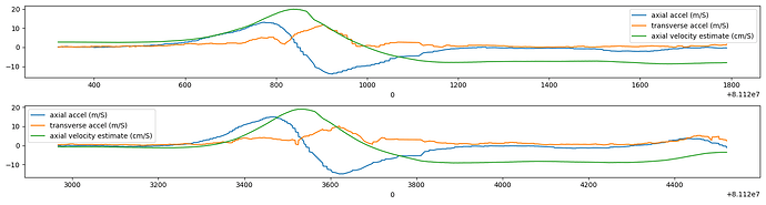

Some stab telemetry is shown below. I generally get about ±10m/S acceleration and 20cm/S velocity for a full-speed full-distance stab. The current thresholds in my props are ±5m/S for acceleration and the 20-17cm/S for velocity. Right now I have to work really hard to reach that 20cm/S velocity threshold.
If you stab a shorter distance you probably can not reach the 20cm/S velocity threshold. So you might be able to just reduce the velocity thresholds and keep everything else the same. My duration check is pretty generous so I think it will still work for shorter stabs.

It feels like the threshold should be more like “we travelled at least 30cm in less than 300ms” rather than “for 200ms, we travelled at least 20cm/s”, but maybe those two things are basically the same?
The velocity curve always has that gaussian bump shape, so by requiring minimum velocity I’m basically also requiring the area under the velocity curve (the distance) to be some minimum as well. I could try to actually integrate the velocity for a distance estimate, but I feel like that would be pretty unreliable - the velocity estimate is already not that great.
