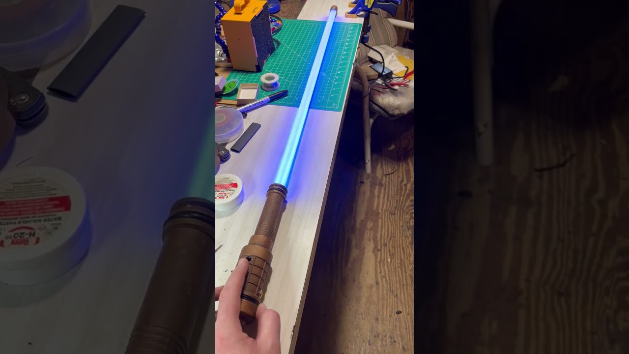

But, after some reworking at the base of the strips, and replacing the interconnecting data lines, I’ve moved to beta testing!
This is a simple Fett263 rotoscope with a Ventress font. I’m keeping most of the other styles a secret until the prop is complete. Plus I feel like all blades should spend some time as a saber to create a baseline for effects.
But as you can see, we’re at full cobb.
I have some blade film coming, and new foam. I tried the diffuser from Amazon, but a simple flashlight test showed how uneven it turned out. What I hadn’t been considering the mathematical value of distance, and how a 3/4" blade is related. We’ll see how it looks and then maaaybe go back to a dual strip set up. That would double the distance btw the interior blade surface and the LEDS.
But then again, it’s not a lightsaber so it will depend on the user’s taste. She was able to try out the button placement and motion controls, and try edit mode.
I received some satisfying feedback: “I’m totally winning the costume contest this year.”
So with everything loosely set, it’s time to rest and wait for parts.
