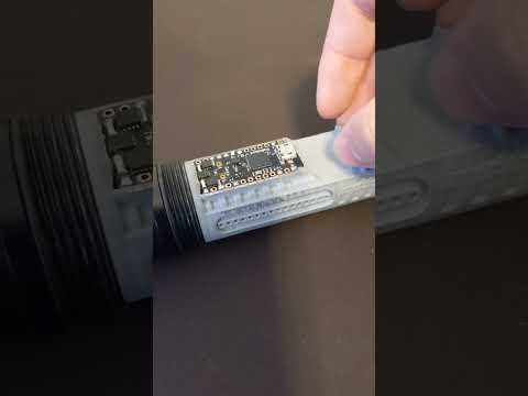

I’ve had this specific saber for about a month. This issue only started happening yesterday. One of two things happen:
I get random SD card not found errors upon de-activating the killswitch. Lights on chassis/hilt turn on.
I get no verbal error, and nothing seemingly happens when I de-activate the killswitch. No lights, saber doesn’t work. This doesn’t happen if I take the SD card out, however. Also, if I attempt to plug it into the computer in this “frozen” state, my PC does not register the board.
I was able to narrow this down to this likely being the board. Things I’ve tried:

just letting you know i tracked down the issue - in my case it was likely driver related since i have zero issues with the saber in question when i use my other pc to write configs to the board
also worth mentioning that i think the solutions before were a fluke even if there is a statistical substance to them. at a certain point, all solutions i mentioned prior stopped working and i kept encountering read errors.
it seemed like something was going wrong in the write process- presently, ~90% of writes to the board using the problematic PC ended up with issues. sometimes i got a good one, and there were no issues until it came time to re-upload to the board, but obviously this isn’t ideal if you’re constantly fiddling with the config.
i also sent the same saber in to someone else for some other issue, and they also had no issue with sd card read errors when they wrote to the board multiple times.
