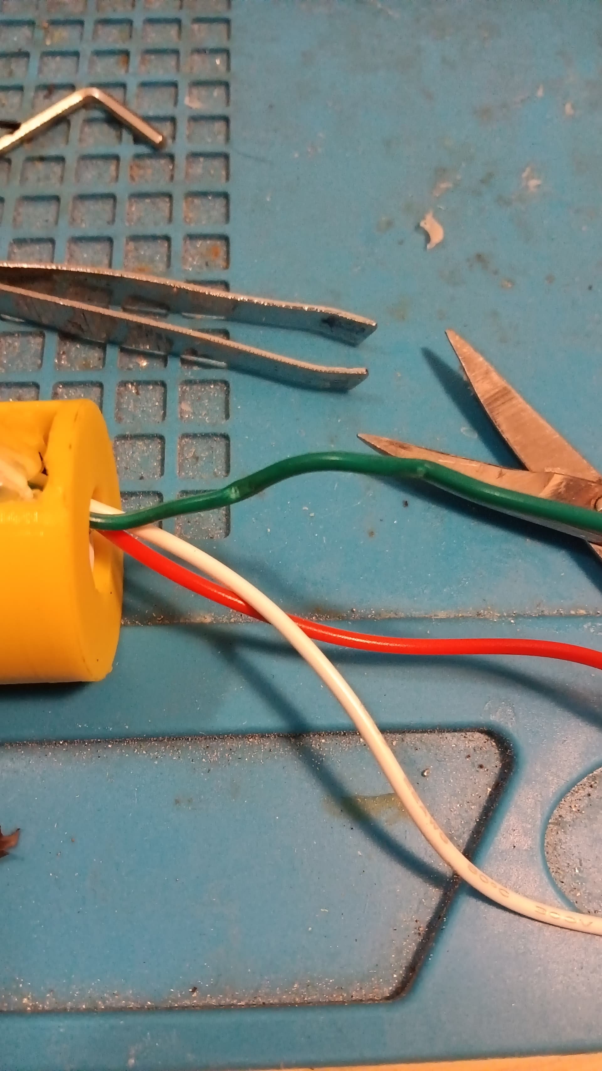

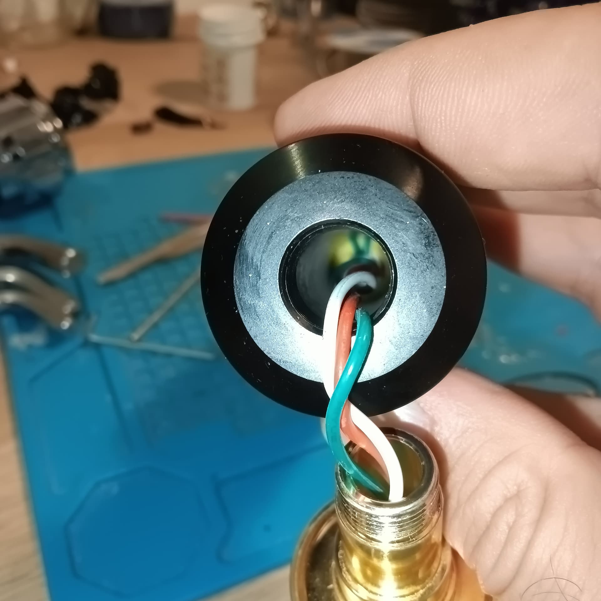

I assembled an Obi-Wan replica with Proffieboard 3.9, a ProffieOS 7.14 WS2812B LED strip, and configuration files from the FET263 website.
The blade is made up of two parallel LED strips of 107 LEDs each and is connected to the Data 1 pin of the proffieboard without any additional resistance (as per the diagram)
The sword seems to work correctly for a while, but then, after some actions that are still unclear to me, the sound continues to work correctly, but the LED strip goes haywire.
The primary color is lost, and the strip turns rainbow-colored, with parts randomly changing color during a clash.
If I turn off the sword, the sounds stop correctly, but the LED strip stays on and maintains its rainbow color.
If I disable the kill switch and then immediately re-enable it, the blade exhibits the same problem described above. If I leave the sword without power for a few minutes, upon rebooting, the blade’s color returns to normal, but after a few seconds, the rainbow blade problem recurs (apparently without performing any action with the sword).
If I leave the kill switch unplugged for 30-40 minutes, when I re-enable it, it seems to work properly for a longer period, but after a while, the problem described above recurs.
