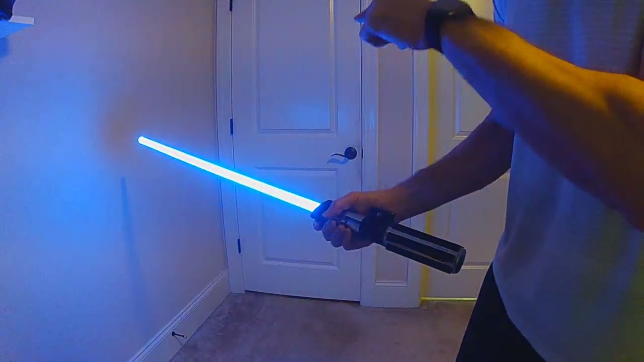

The effect will allow you to introduce additional sound effects that are called by a TransitionEffectL at specific points in an animation as shown below. This will allow a “transition” sound to be called at the exact point in the animation that you want so rather than try to time a visual effect to a sound file, the visual effect can call the sound itself.
You can set up interactive transitions that call an effect at an exact point in the interaction:
Or you can have a TransitionLoop and call the sound(s) over and over, this one is a completely random timing but the visual effect and sound effect are in perfect synch because they are called simultaneously by the style code:
