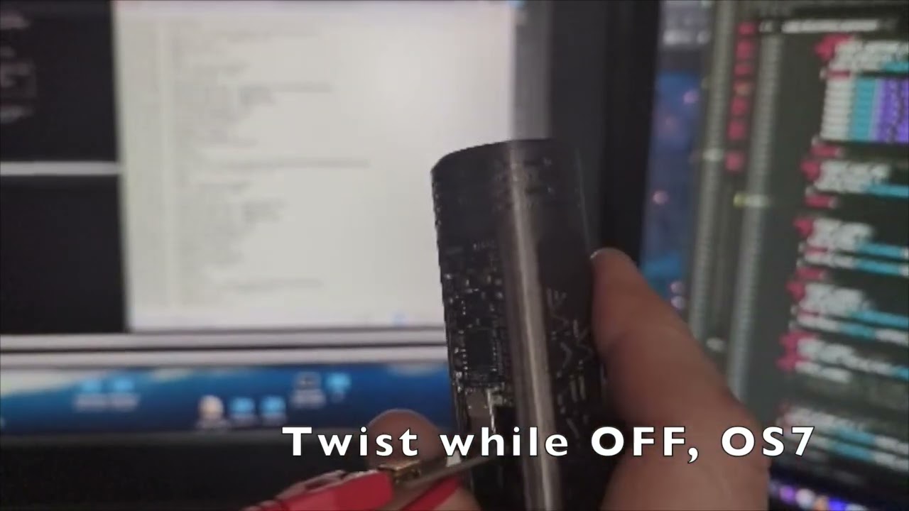

Hey, I have been doing some more testing with twist on / off, and I’m still getting the feeling it’s not the same as OS6. It’s less responsive to the twist gesture. Here’s the Serial Monitor output…
To describe it a bit more, it seems like the twist has to be on a perfectly still axis or it won’t recognize it as a twist. Again, this is not what I’m reading in Serial Monitor, but what I’m feeling when attempting the twist gesture with multiple sabers running 7.3 Beta.
Hoping you can help!
@profezzorn was something changed for DetectTwist() or that might affect DetectTwist() while the saber is OFF?
It seems that EVENT_TWIST is not returning (or working like it used to) while the Saber is OFF, it functions fine while ON but I can’t see anything that would cause.

Tested this in OS7 but still not detecting Twist while Off.

I can confirm that OS7 is more picky with something about the twist motion. I want to say it needs to either be slower intentionally, or it needs to return to the same point it started from(or slightly beyond) ??
This is just 2 presets, doing next_preset on Twist while pointing up.
I’ve noticed it, too. Works fairly well on my skinny LGT hilt, but is more finicky on my thicker S3. Not as smooth as 6.7.
I’ve noticed something similar, almost like the twist has to start at one point and return to a farther point on the opposite end of the twist. With 6.7 the twist was so easy and so dependable.
It’s almost too easy to not get a proper twist on than it is to get a proper twist on in OS7 thus far.
Thanks to all who are helping identify, and to Fett/Fredrik for jumping on to solve.
Confirming Twist-Off is definitely more finicky. Reverted to OS6.8 and then 7.0 and it went away.
There is a monitor strokes command that that might help pinpoint the difference. It will show more details about the gesture recognition in the serial monitor.

00:59:57.348 -> Stroke: TwistRight len = 7 separation=54 mss={-0.50, -0.38, -1.87} swspd=0.00
00:59:57.797 -> Booster off.
00:59:58.489 -> Stroke: TwistLeft len = 158 separation=793 mss={-0.34, 0.86, -1.08} swspd=0.00
00:59:58.773 -> Stroke: TwistRight len = 87 separation=127 mss={-1.15, -1.54, 3.11} swspd=0.00
00:59:59.679 -> Stroke: TwistLeft len = 41 separation=772 mss={-0.11, -1.37, -0.41} swspd=0.00
01:00:00.021 -> Stroke: TwistRight len = 112 separation=73 mss={-0.42, -1.34, 2.38} swspd=0.00
01:00:00.021 -> TWIST
01:00:00.021 -> EVENT: Twist millis=48654
01:00:00.021 -> ****** SetPreset 48654
01:00:00.021 -> Style RAM = 2112
01:00:00.021 -> Scanning sound font: testfont2b done
01:00:00.123 -> Scanning sound font: common done
01:00:00.190 -> Scanning sound font: commonBU done
01:00:00.534 -> Activating polyphonic font.
01:00:00.637 -> Activating SmoothSwing V2
01:00:00.637 -> Accent Swings Enabled.
01:00:00.637 -> Polyphonic swings: 1
01:00:00.637 -> Monophonic swings: 0
01:00:00.637 -> Accent Slashes Enabled.
01:00:00.637 -> Polyphonic slashes: 1
01:00:00.637 -> DISPLAY:
01:00:00.637 -> testfont2b
01:00:00.637 -> unit = 0 vol = 0.50, Playing testfont2b/font.wav
01:00:00.672 -> channels: 1 rate: 44100 bits: 16
01:00:01.633 -> Stroke: TwistLeft len = 143 separation=1470 mss={-0.01, -0.11, -1.04} swspd=0.00
01:00:01.909 -> Stroke: TwistRight len = 140 separation=121 mss={0.24, -1.41, -2.52} swspd=75.80
01:00:01.909 -> TWIST
01:00:01.909 -> EVENT: Twist millis=50548
01:00:01.909 -> ****** SetPreset 50548
01:00:01.909 -> Style RAM = 80
01:00:01.943 -> Scanning sound font: aa_JayDalorian/Blastermode done
01:00:02.010 -> Scanning sound font: common done
01:00:02.046 -> Scanning sound font: commonBU done
01:00:02.330 -> Activating polyphonic font.
01:00:02.396 -> Activating SmoothSwing V2
01:00:02.396 -> Accent Swings Enabled.
01:00:02.396 -> Polyphonic swings: 7
01:00:02.396 -> Monophonic swings: 0
01:00:02.396 -> Accent Slashes NOT Detected:
01:00:02.396 -> DISPLAY:
01:00:02.396 -> testfont2b
01:00:02.396 -> unit = 0 vol = 0.50, Playing aa_JayDalorian/Blastermode/font.wav
01:00:02.396 -> channels: 1 rate: 44100 bits: 16
01:00:02.983 -> Stroke: TwistLeft len = 70 separation=991 mss={-0.45, -0.07, -0.04} swspd=0.00
01:00:03.223 -> Stroke: TwistRight len = 81 separation=113 mss={-0.35, 0.70, 2.23} swspd=0.00
01:00:04.281 -> Stroke: TwistLeft len = 8 separation=971 mss={0.20, -0.62, -0.19} swspd=0.00
01:00:04.625 -> Stroke: TwistRight len = 80 separation=125 mss={-0.90, -1.41, 3.98} swspd=0.00
01:00:04.972 -> Amplifier off.
01:00:05.520 -> Stroke: TwistLeft len = 118 separation=693 mss={-0.44, 0.18, 1.88} swspd=0.00
01:00:05.656 -> Stroke: TwistRight len = 34 separation=92 mss={-1.02, -0.18, -1.84} swspd=0.00
01:00:05.964 -> Unmounting SD Card.
01:00:06.652 -> Stroke: TwistLeft len = 166 separation=716 mss={-0.66, -0.17, -2.59} swspd=58.93
01:00:06.820 -> Stroke: TwistRight len = 46 separation=121 mss={-1.07, 2.42, -1.96} swspd=0.00
01:00:07.784 -> Stroke: TwistLeft len = 198 separation=643 mss={-0.40, 0.91, -2.46} swspd=0.00
01:00:07.953 -> Stroke: TwistRight len = 97 separation=100 mss={-0.77, -0.95, 5.62} swspd=0.00
01:00:07.953 -> TWIST
01:00:07.953 -> EVENT: Twist millis=56609
01:00:07.953 -> ****** SetPreset 56609
01:00:07.989 -> Style RAM = 2112
01:00:07.989 -> Scanning sound font: testfont2b done
01:00:08.093 -> Scanning sound font: common done
01:00:08.128 -> Scanning sound font: commonBU done
01:00:08.477 -> Activating polyphonic font.
01:00:08.579 -> Activating SmoothSwing V2
01:00:08.579 -> Accent Swings Enabled.
01:00:08.579 -> Polyphonic swings: 1
01:00:08.579 -> Monophonic swings: 0
01:00:08.579 -> Accent Slashes Enabled.
01:00:08.579 -> Polyphonic slashes: 1
01:00:08.579 -> DISPLAY:
01:00:08.579 -> testfont2b
01:00:08.579 -> unit = 0 vol = 0.50, Playing testfont2b/font.wav

The majority of swspd in OS7 are 0 except when it works, then there’s a value?
That’s not consistently true, but maybe something?
swspd=0 is definitely a bit peculiar, investigating…
Ok, found it!
There was a race condition in the fusor, it would cause the swing speed (and other things) to become zero in some cases. Should be fixed now. (On github master.)
Confirmed. Works each and everytime now effortlessly.
