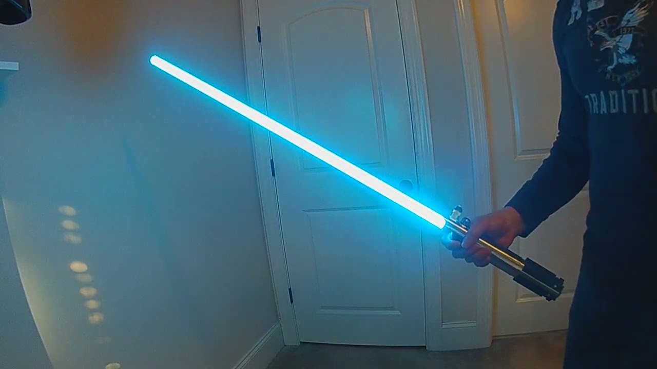

Demo of library options:
I am officially launching Phase 4 of my Early Access Library and to kick off the new library I have added the new āANH Training Remote Mini Gameā along with a bunch of new options and controls.
Based on the Training Remote scene in ANH, this Mini Game uses hovering/movement sounds (hisses) and blaster firing sounds.
To successfully deflect the incoming bolts you must quickly swing your saber immediately after the blaster firing sound plays, however, if you swing early you need to bring your saber to a stop before the next swing is needed. If you swing before the blast sound or during a movement sound and do not reset to a rest you cannot successfully deflect.
To Win Mini Game you must complete Three Consecutive Successes before receiving Three Strikes. If you get Three Strikes you will lose the Mini Game and your saber will retract automatically. In order for this game to work you will need to include the necessary sounds in your font.
Jesse at Kyberphonics has graciously donated the necessary sounds to all of my Early Access Patrons, so you can download the necessary sounds from the library when you add the Mini Game to your style. The style code will include the information on the required sounds, so you can make or customize yourself, but you can use the sounds from Kyberphonics right away by adding them to your font and uploading the new style code.

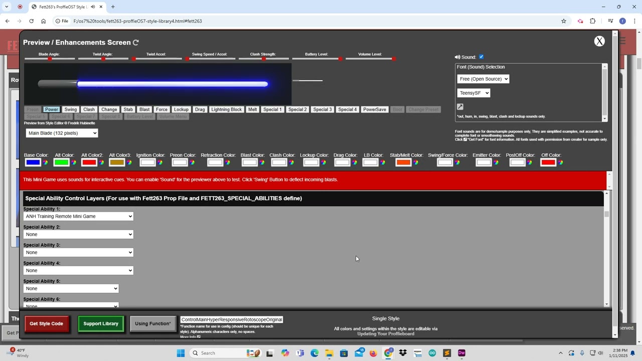

There is a bunch of customization available for how the game looks and works and you can choose from several control options; Special Abilities or an Interactive Preon Unlock (which makes it so you need to successfully win the game to use the saber, if you lose the saber will turn itself off).

When I use the preon version of the ANH Training Mini Game, should I be able to select for alt font as part of the āprizeā?
Iām getting instructions for alt font at the top section of your library output when itās set as special ability, but not as a pre on. Everything else seems good! Extremely cool and really fun when testing with friends today ![]()
It āshouldā, I may need to update the output for the style information. Iāll have a look later.
I tried a couple of times to verify.
Itās possible the script is missing that variable, Iāll review when I get a chance.
In the interim, please see message I sent.
So it looks like i missed that option in the Preon script. Iāll try to get it added in the next day or two.
This should be fixed, there was actually a few small bugs with the Prize Alt Font set up so I had to change several things around. If anything doesnāt work as expected just let me know the options you selected so I can replicate.
Youāll need to refresh the page to get the updated scripts.
