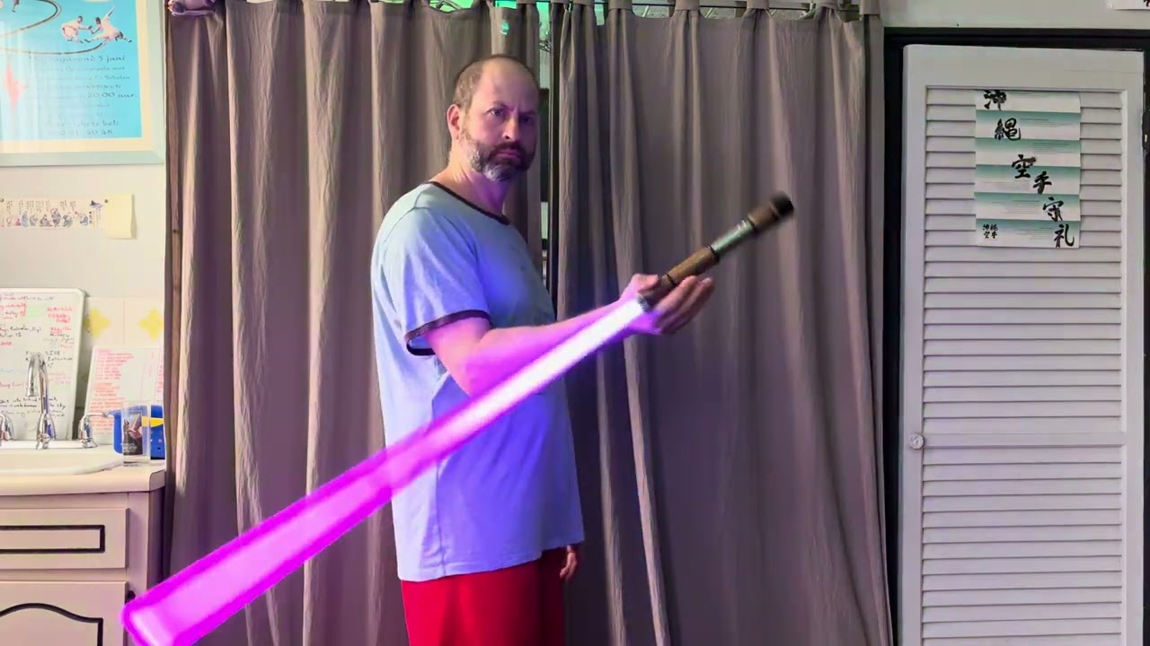

So for my first test has it running but it’s slow on the switch up.
Video of first test:
The sound at the beginning is a classic “Boots to the Head” .wav as a activate spin mode.
Summary: detects angle and switches blade styles successfully but there seems to be a lag. A full spin seems to be too fast for it to detect the angle and change styles (so the blade stays constant). After the video I did an “orbit” and froze at different downward angles and the blade would eventually change over.

It is probably the BladeAngle<> function, I’m not nearly as good at spinning so I can’t get to those speeds. The Mix<> is pretty responsive but if the BladeAngle<> function is slow to return the updated value it could be slightly behind where the blade actually is. I’ll see if I can tweak the function a bit but will probably need someone better at spinning to test.
Glad to help test.
I have a theory, can you try it again with just “Static” blades with different colors and add the following define. I did a simple test and Mix<> is normally pretty responsive but more complex blade styles might be delaying the BladeAngle<> calculation a bit. Also, in the beginning of the style look for “BladeAngle<>,Int<16000>”, just change the 16000 to 16384 (very minor tweak) just to give the blade a true 50/50 break.
This define will give a little more “juice” to the visual effect processing (in theory) and then running just “Static” blades should free up the processor to calculate blade angle faster. From there we can try other styles (try to avoid anything Fire or Unstable as those typically require the most processing). There’s going to be a tradeoff the faster you intend to spin and the speed the board can process the angle and effects together.
