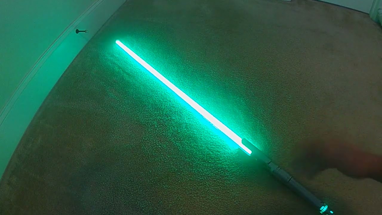

ProffieOS7 Style Library “Yin and Yang Blade” Style for Blade Builder
There’s so many new styles, effects and options in the OS7 Library already I won’t be able to demo them all but I wanted to show another new Dual Phase (Blade Builder) style that is in Phase 1. The “Yin and Yang” Blade option allows you to mix two blade styles/colors into one blade, your “Yin” will display anytime the blade is parallel or up and the “Yang” will display anytime your blade is below parallel. You can choose any styles or colors you want to build completely unique blades that react in real time to the angle you have.
And for those who are able to spin their sabers you can generate a sort of “Yin and Yang” persistence of vision effect with the two styles in motion (unfortunately I don’t have room or skill to do so ;-).
For those with Early Access to the OS7 Library be sure to check this new style out an build your own custom version in the Blade Builder and be sure to look through all of the new options and capabilities in Phase 1!
