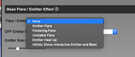

Could you guys add OPTIONS for Emitter Flare? That way we can chose to enable/disable in Edit Mode/WebUSB. I was able to rig this to work using Swing Options, which is cool since I pretty much use one option there, so I know it’s possible.
What is emitter flare exactly and how do you think it should work?
Sorry, I think I meant “Base Flare/Emitter Effect” - Emitter Flare is an option in that:
Screen Shot 2022-06-13 at 1.59.28 PM
It would work like the other options available; being able to choose what emitter option you wanted based on ColorSelect<IntArg<EMITTER_OPTION_ARG, 0>… presumably.
I have it already working, but using SWING_OPTION_ARG instead, so it would be nice if it had it’s own option to be used in conjunction with swing options.

It’s an effect in my library that adds a localized color or effect at the base of the blade.
You can just do
ColorSelect<IntArg<33,0>...>
IntArg 1 ~ 32 are dedicated to Edit Mode but you can add user specific arguments to IntArg sequentially above 32 for anything you wanted.
Now if you’re asking to have more Argument options added to Edit Mode itself, that’s a bigger ask as it would require new menus and voice prompts to support, I’m on the fence about expanding the menu system at this time.
In my set ups I would just make a preset with an emitter flare and a preset without an emitter flare and change the Style Number itself when you wanted to toggle. If all other layers are the same the addition of a style with an emitter flare wouldn’t take up much more memory. This would be simpler than adding another argument and menu to support it as it’s a lesser used option.
I see what you’re saying, that makes sense. That’s super great though there are more IntArgs to use! I’ll experiment with adding a 33 IntArg and see how that goes. For me, it’s nice to be able to quickly add a base flare to any style on the fly and see how that looks and keep all else the same.
If you build identical styles, one with a base flare and one without and put them into your config consecutively, then changing the style number would do this exactly :wink:
It would have all other colors and edits in place and just drop in your base flare, this was actually how the original test styles in Beta testing were designed.
It would, but I already have 13 styles in there already… I don’t want to have 26+ with those duplicates. Plus, I have Stable Flare, Flickering Flare, and Unstable Flare options, so that’s x4 needed :grimacing:
