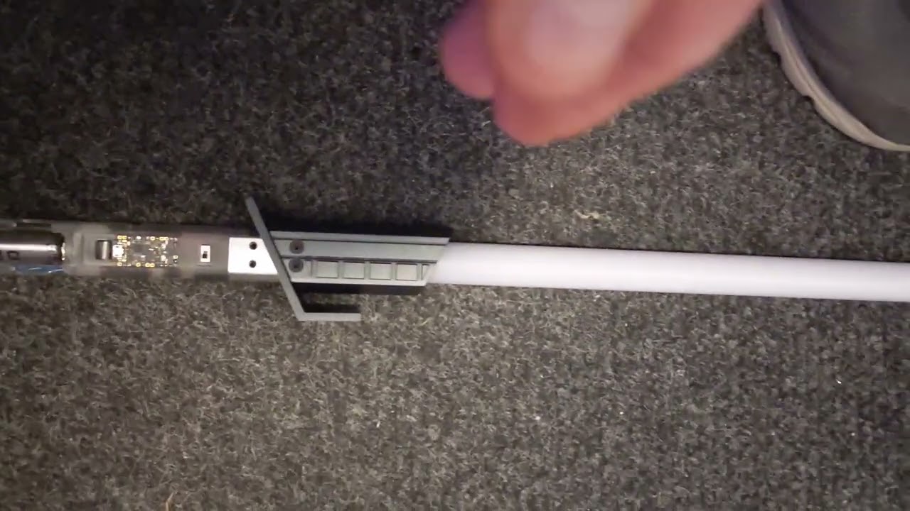

Thatās a pretty cool start point. I was thinking of it having independent one-button prop controls for each blade on one board.
@NoSloppy Nice. Share the trick.
