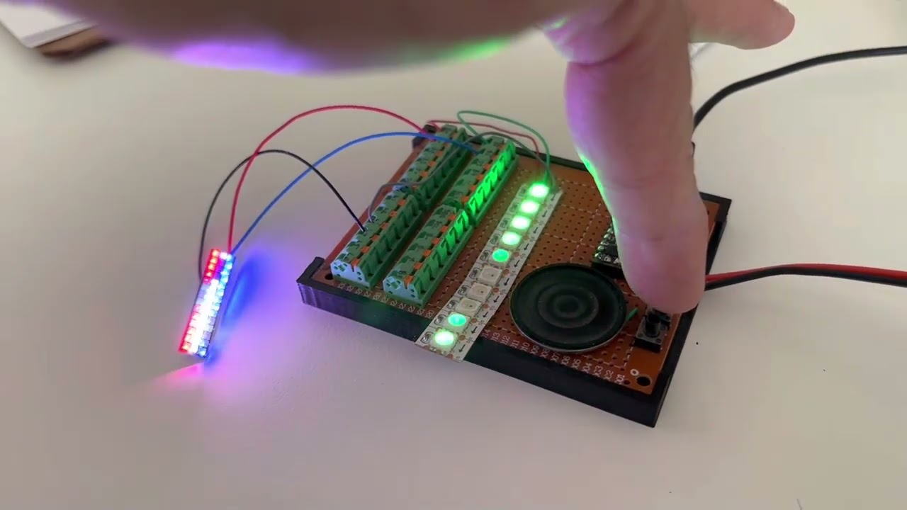

SubBladeZZ was tested a while back, but reporting it in the official testing thread.
Proof of life video:
