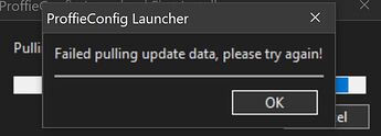

Hi Ryan,
when trying to install, I get this error (on Windows10)
This is after modifying the state file? What does that file look like currently?
EDIT: I’m able to reproduce this… looks like it’s 403’ing… which is weird…
Hmm, ok. On my machine something about the PROPS section from v1.7 is messing with the pconf parser. If I had to guess it’s an oversight with Windows line endings.
If I remove the props section (since it’s no longer used anyways) and the add the manifest entry, things seem to work, however for some reason it simply won’t update. It recognizes the new version (I can see in logs) but it simply skips over it.
Weird that on other platforms it updated fine… that’s something I’ll take a look at tomorrow.
For now:
If you experience that, you can uninstall but keep user data, then reinstall with the new launcher and with the state file setup with the manifest entry.
Well, I did say to expect broken things :sweat_smile:

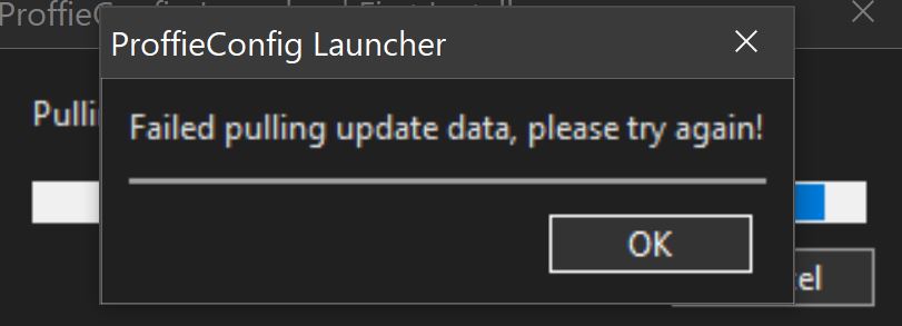

I first did uninstall previous version (was installed in March 2025) I kept user data.
I am getting the same error with the launcher from this page:
If you try to download
https://proffieconfig.kafrenetrading.com/assets/appsupport/update/manifest.pconf
(Or manifest-beta.pconf)
Are you able to?
Sounds like maybe something’s being weird for you server side…
The old launcher version shouldn’t have any reason to have that issue…
Unless I messed something up very bad.
I’ll get back to you on this tomorrow, it’s very possible I messed something up on the server.
EDIT: I’m not able to… it’s 403’ing. Something seems to have been broken on my end.
Stand by.
@olivierflying747-8 Try it now and see.
EDIT: Okay. I’m running through things on an actual windows machine and it seems there’s several critical things broken that didn’t present themselves before.
That’s disappointing, but for now I’d just hold off on messing with it.
I’ll try and get that fixed tomorrow and send out the new build.
I’ll let you know when I do.

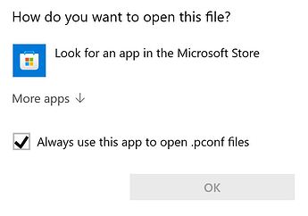

I downloaded it but I have no idea what to do with a “.pconf” file ?
You can open it in a normal text editor.
You don’t need to though.
I was just curious if you could download it with a normal web browser, but it turned out I broke things server side and whether or not you could actually download the file was just fiddy so I didn’t realize. (I.e. it worked for me on the other computer, but not others or for you)
I managed to open it with Sublimetext. It’s bed time for me now. So I’ll try again when you post an update.
