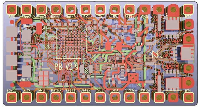

Circuit diagram & BOM is now available here:
https://fredrik.hubbe.net/lightsaber/v6/board.html
The kicad files require some work before I can post them, but they will be available soon as well.
In your V2.2 you had a Solidworks file. That or a Step would be great for designing. I guess I could use a V2.2 model for most things, but still.
The V3 is exactly the same size, so having a new model would just be for looks.
I’ll see if I can convince kicad to export some sort of 3d model.
Is it just me, or are PCBs kind of… pretty?

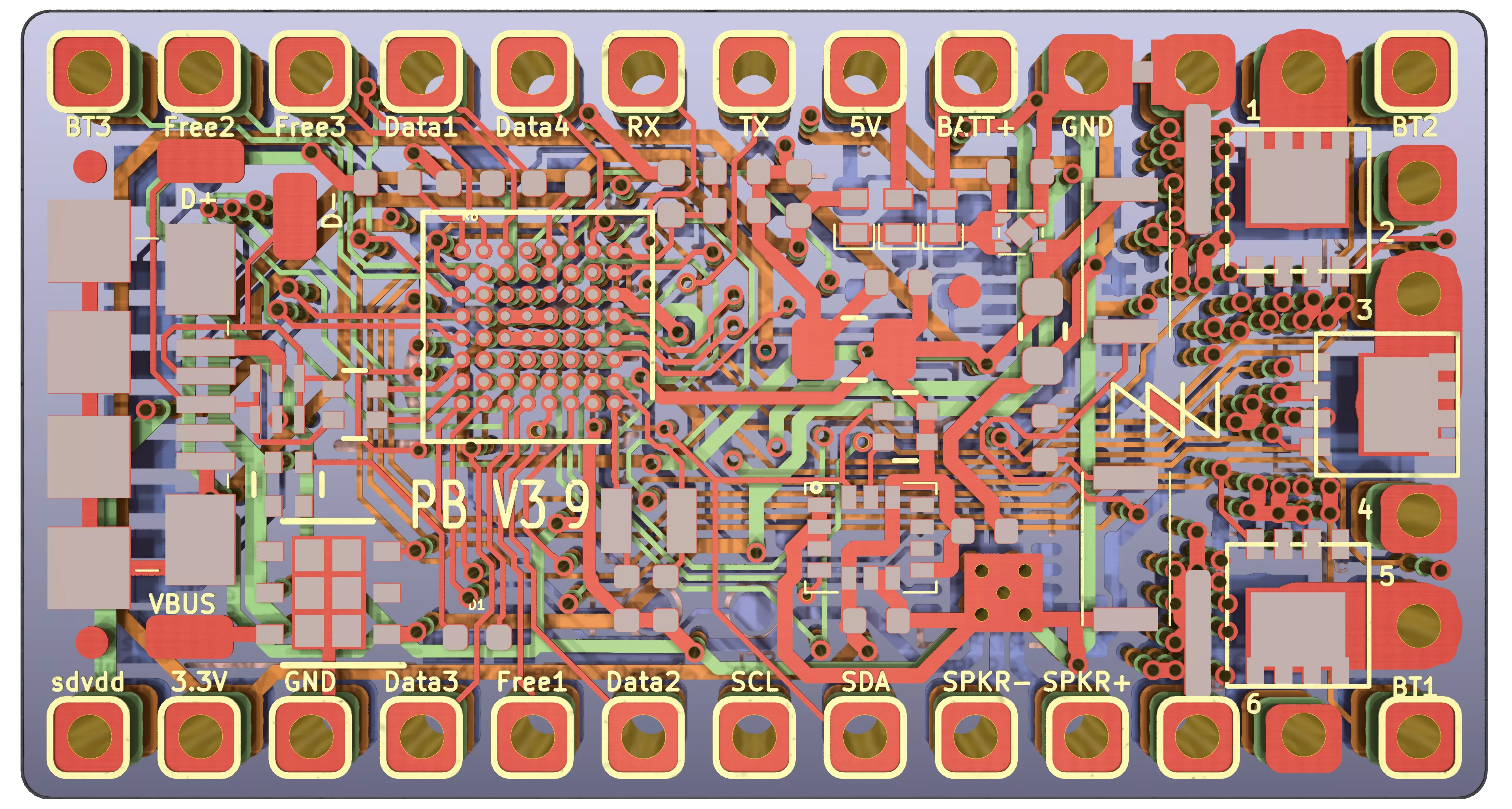

V3 kicad files are now available:
