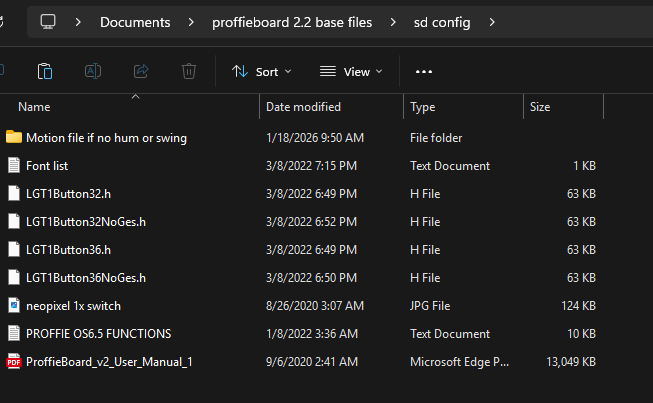

thats what i also thing that its not reading the sd card because it says the same garbled mumbo jumbo without the sd card also where would i find those error codes im not seeing any in mine
this is in the sd config file
IMO, you’d be best served figuring out your battery issue first. The audio being wonky is perfectly normal without proper battery power. Once you’ve fixed that then you can deal with the SD card, and be more able to actually hear the errors.
The errors themselves though are all sounds. (There’s nothing to see on the sd card) That’s what you’re hearing:

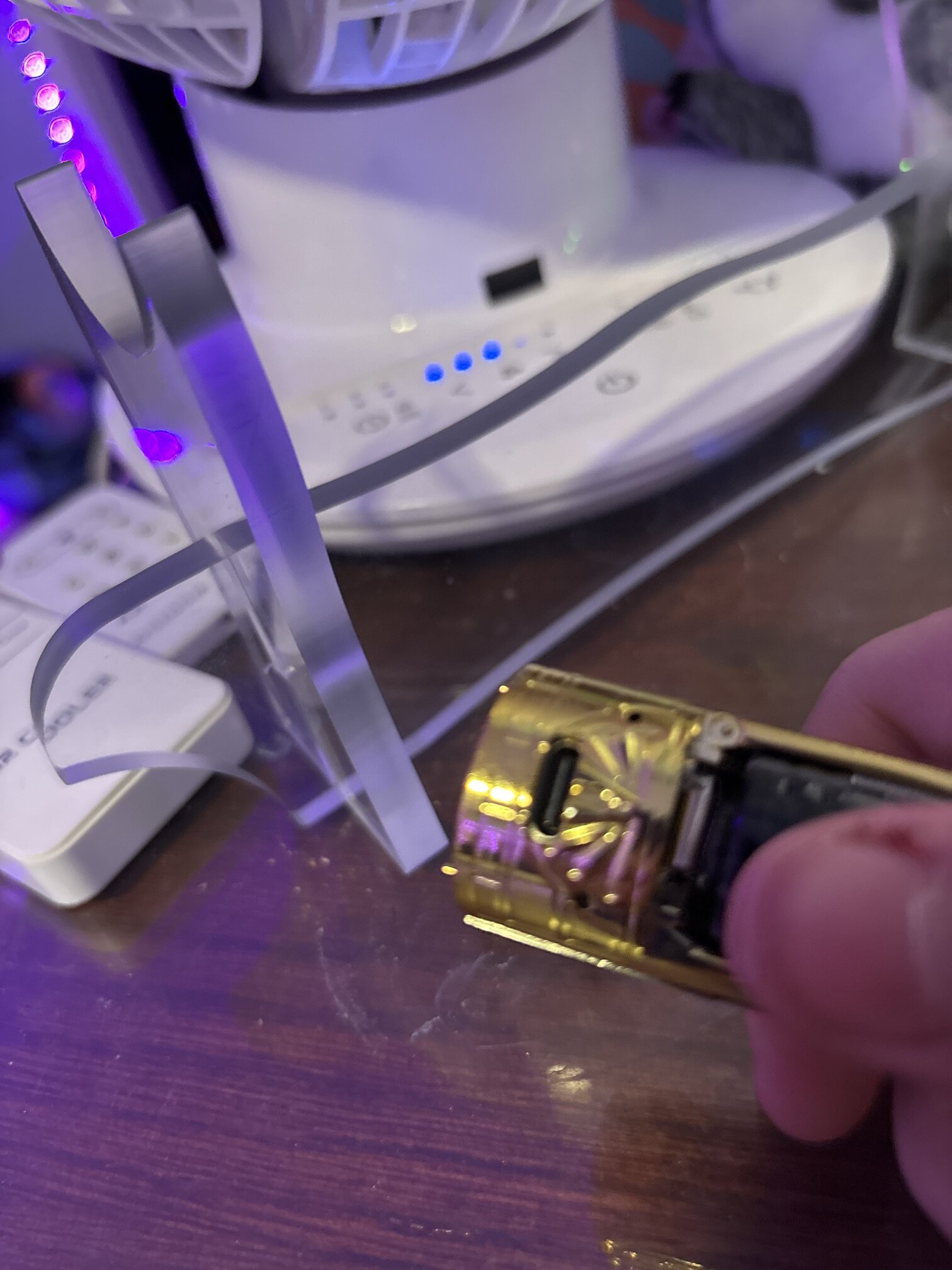

Are you sure you are charging the battery? Where are you plugging into the saber? This sounds like a dead battery or you’re only getting power from USB.
Maybe a pic of where you’re plugging into?
I plug it into the charging port
Are you turning off the kill switch?
Maybe try an external charger for the battery, seems like the battery isn’t charging or there’s an issue with board.
theres a red light indigating that it is charging or receiving power (im pretty sure it means charging cause when it turns green it means its fully charged)
