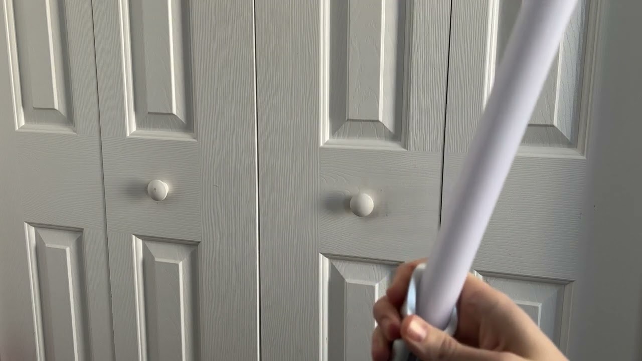

I have an old Imperial Workshop Scavenger 2.0 that uses a single button Proffie core. I’ve done light dueling with it for years and it’s been fine. Until the other day when this happened. Any ideas?
I would guess it’s a broken D61 since it won’t come on unless you have the charger connected.
It’s hard to say more without knowing how it’s wired and configured.
Is a broken D61 fixable? I’d like to repair this core if I can. It’s a standard LGT Proffie 1 button core from 2021.
