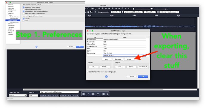

Export window should have drop down menus set to File Type: WAV (Microsoft) and Encoding: Signed 16-bit PCM
In Preferences, under Import/Export, you can turn on the checkmark for Show MetaData on export. Then you want to clear anything in there when you export (see image)

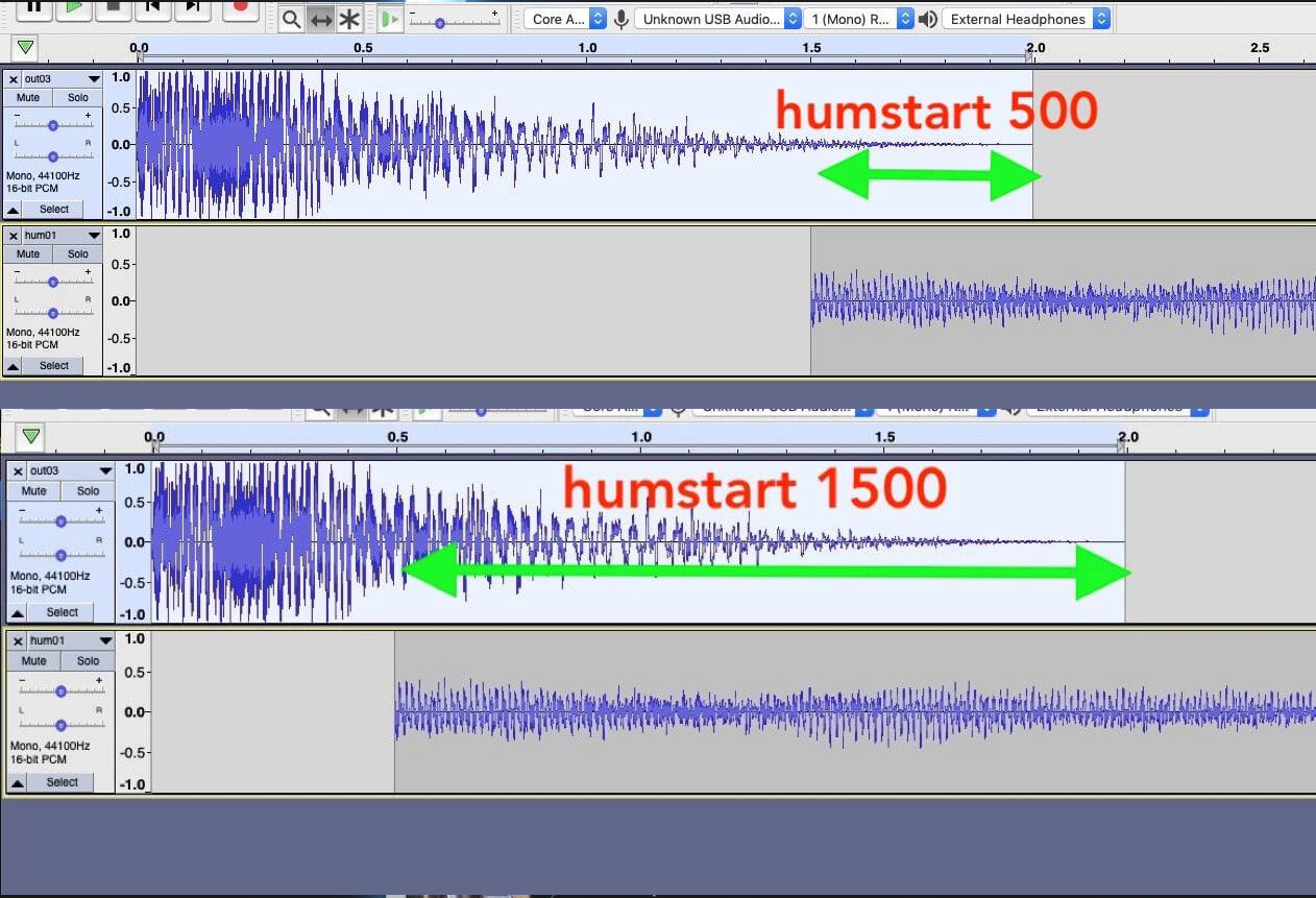

There was a guy who posted how his font sounds, where he’s getting pauses and dead spots between sounds.
First thing (chronologically of use) is the out.wav played at ignition.
Because it’s a polyphonic font, you have hum playing underneath the other effect sounds. Well, the ignition has a delay until the hum fades in so that the initial burst of the out.wav happens first. This time is controlled by the humstart value found in the config.ini file that lives in the font folder.
It is in milliseconds, and behaves opposite of what you would think. The time set is how long from the END of the out.wav the hum should start playing. Here’s a visual example:
So taking Greyscale Font’s Deadlink as an example, the out.wav is long at 3.2 seconds. So unless the humstart is set to about 3000, there’s going to be an unnatural delay until the hum is audible.
Typically the default humstart is 1800, with most out.wavs being 1500-2000ms long.
TL;DR if you are going to do long out.wavs, just make sure the humstart is about 80% of the total length of the file to keep things sounding right.
