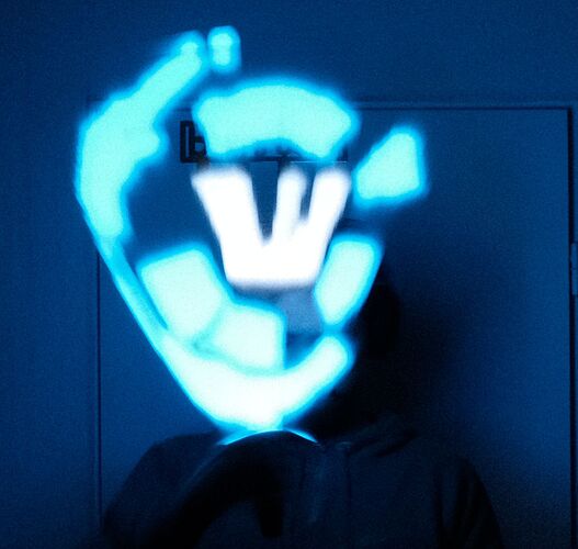

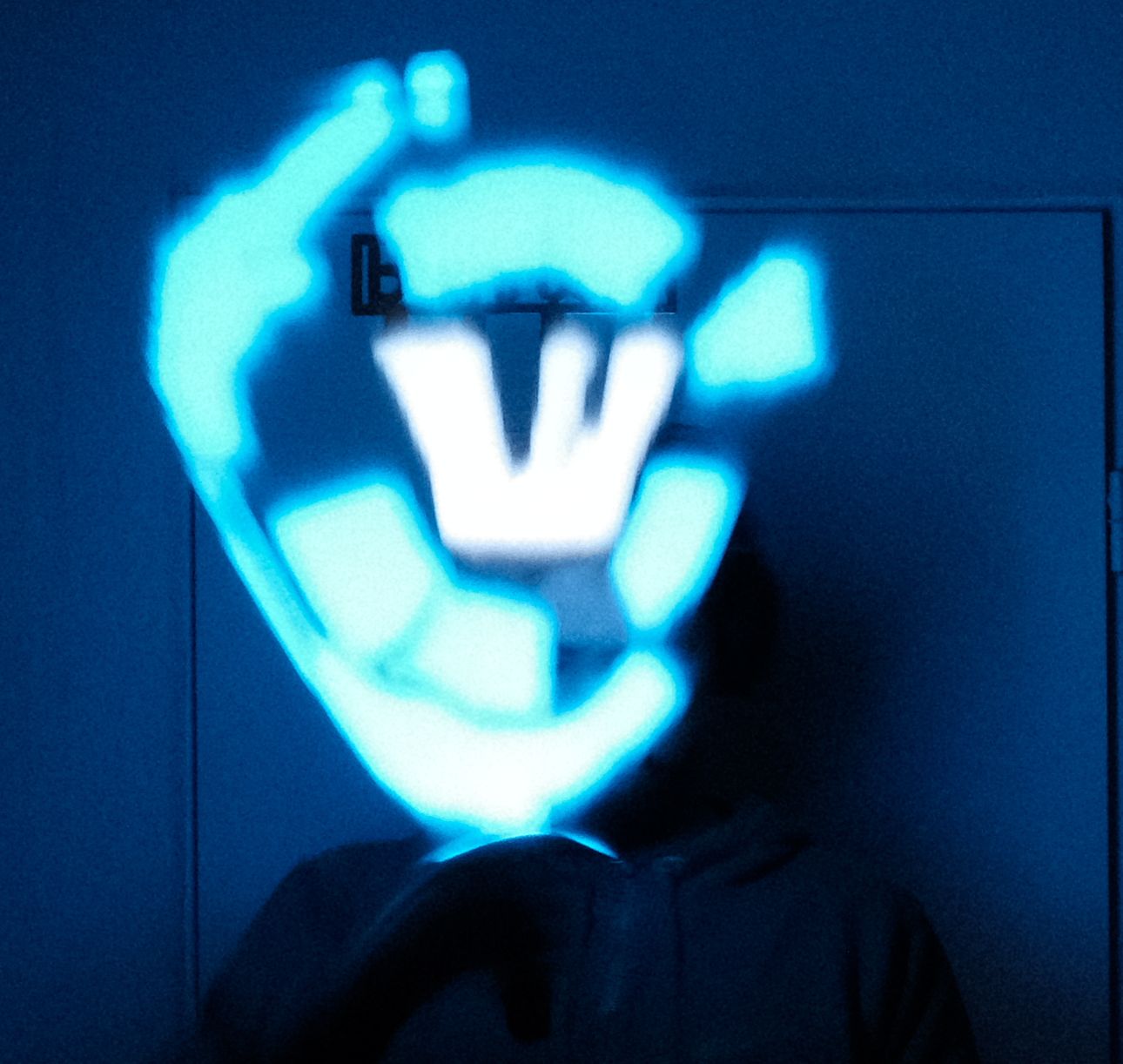

Meanwhile I tried reducing the angles in half (400 width for a 144px blade → 200x72 wiperimage for my 72px blade)
shadowfoil_72_preview
This almost halfed the size again 23.8kB from 44.5kB
It works, but not sure if the quality is worse :wink:

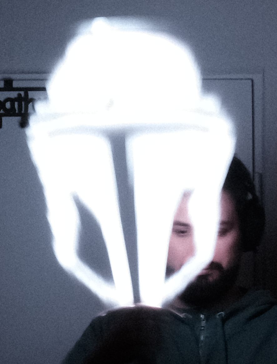

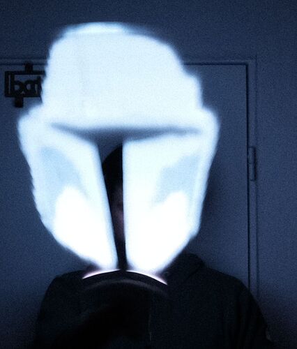

Here are some more pictures with a wiper image of 200x72.
