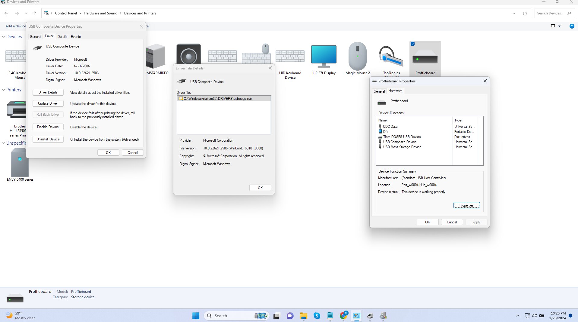

So, you have to click on each of these device functions and check their drivers.
I think one of these things is actually the serial port, but with a bad driver attached to it. The most obvious suspect would be the “CDC Data” function, but I think that is actually the WebUSB device.
I’m also a it suspicious of the last device, since there seems to be three mass storage functions here. I’m not sure what happens if you try to attach a mass storage device driver to a serial port device, it’s possible that it would look weird like this.

I’m trying to compare this to my computer, but it doesn’t look the same.
Is your computer behind on updates? (Or is it perhaps Windows 10?)
In my Windows 11, “printers and devices” doesn’t exist anymore, and there doesn’t seem to be any replacement that shows anything useful…
The problem is that if this is the WebUSB device, then WinUSB is the right driver. If this is the serial port device, then this is the wrong driver…
I see. Well I have no clue how this happened in the first place you can view printers and devices by right clicking in windows 11 in control panel devices and printers and open in a new window
Ok, I was able to find “devices and printers”, I went to Settings → Bluetooth & devices → More devices and printer settings.
Once there, I checked the properties of one of my proffieboards, and it showed exactly this:
… except it also shows a COM port.
That COM port just isn’t there in your listing which is super weird.
I’ve seen lots of cases where people use zadig poorly and screw up their ports, but the device would still be listed here, it just wouldn’t work. I don’t understand what would cause it to disappear completely. I mean, how do you check the driver for something that doesn’t exist??
I don’t suppose if you open up the “device manager”, there is a device listed that is not functioning properly?
I see this too. but in arudino i only see com 3 and com 9. my boards just are not showing up none of them. bad luck with sabers however the com 3 does not show (proffieboard) I am telling you man something happens when you open zidag because it happened to BOTH my PCs
