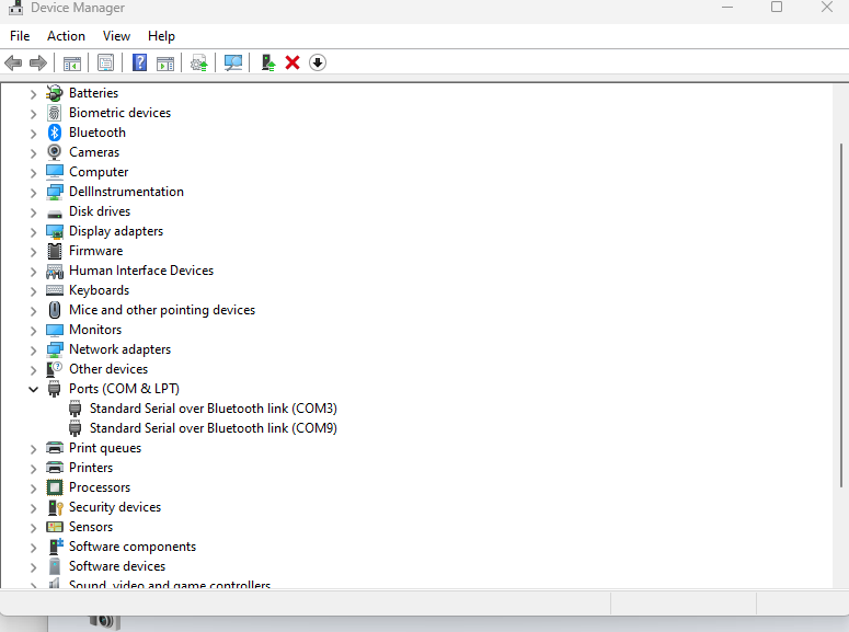

I am testing different boards.
Here are my ports. It says over Bluetooth though…
OMG! It works! Thanks man! IT fixed all boards! Now when I plug in i see the boards! dude thank you
