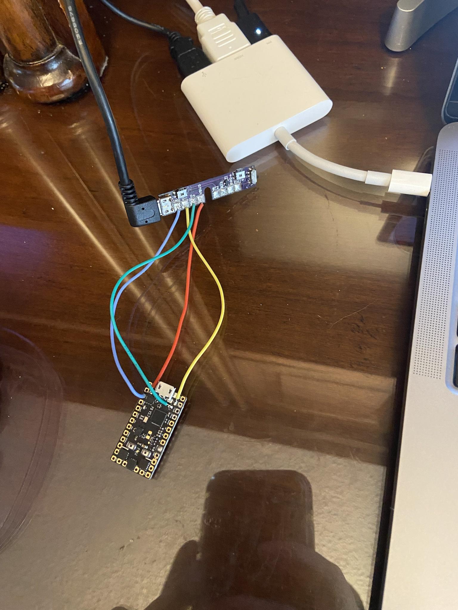

Still trying to find time to really work on things but I did build one of @profezzorn ’s graflex helper boards today and tested the remote USB pads.

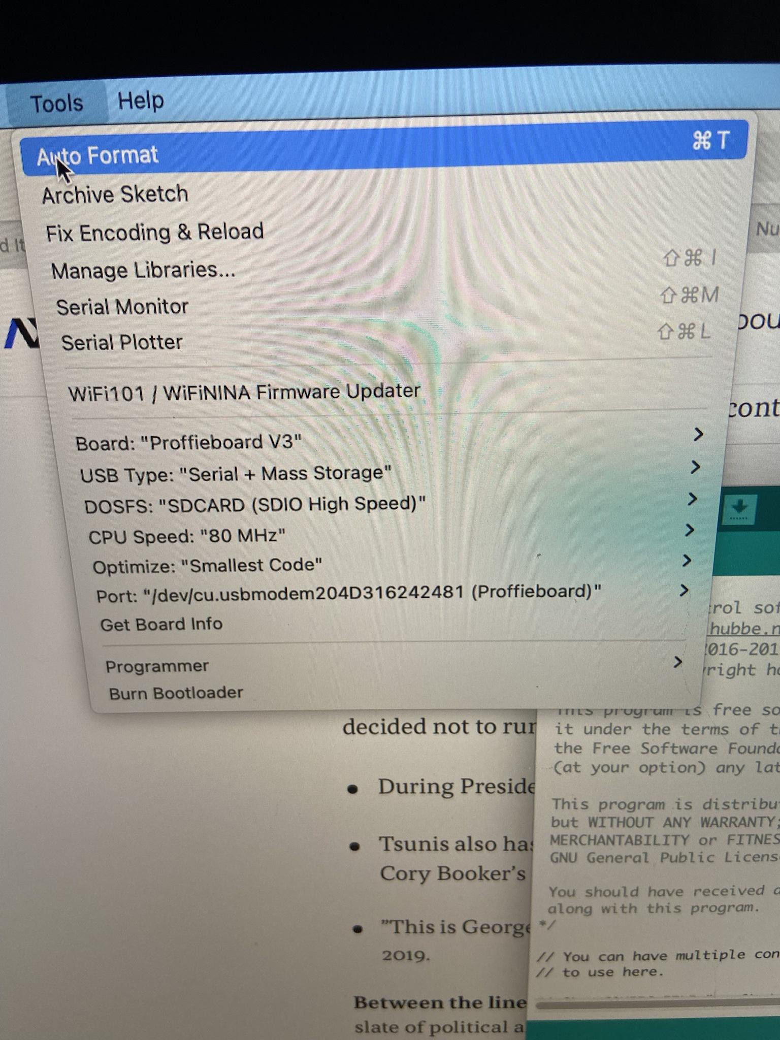

Maybe dumb question but are you sure you chose DOSFS: SDIO (High Speed) ?
Will that impact the CPU?
I may have used regular speed while I was playing around with the new plugin

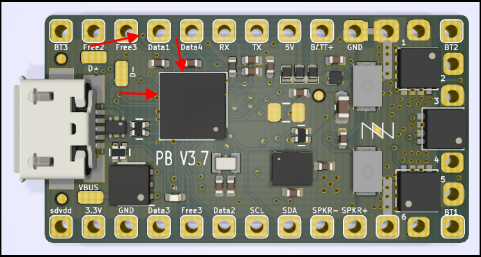

One of the worries about using BGA components is that the tiny gap between the chip and the board might be magnet for small metal bits and/or single strands of copper wire. The power button connects to the chip in the outmost row (in two places) so there is a chance that something like this could have happened.
proffieboard_v37_top
In addition to checking those spots (and maybe blowing it out with some compressed air) there is also a via between Data1 and Free3 that connects to the BT1 pad, so that is another place to inspect for shorts. (top and bottom)
(The doodle-on-a-picture feature can be quite handy sometimes…)
