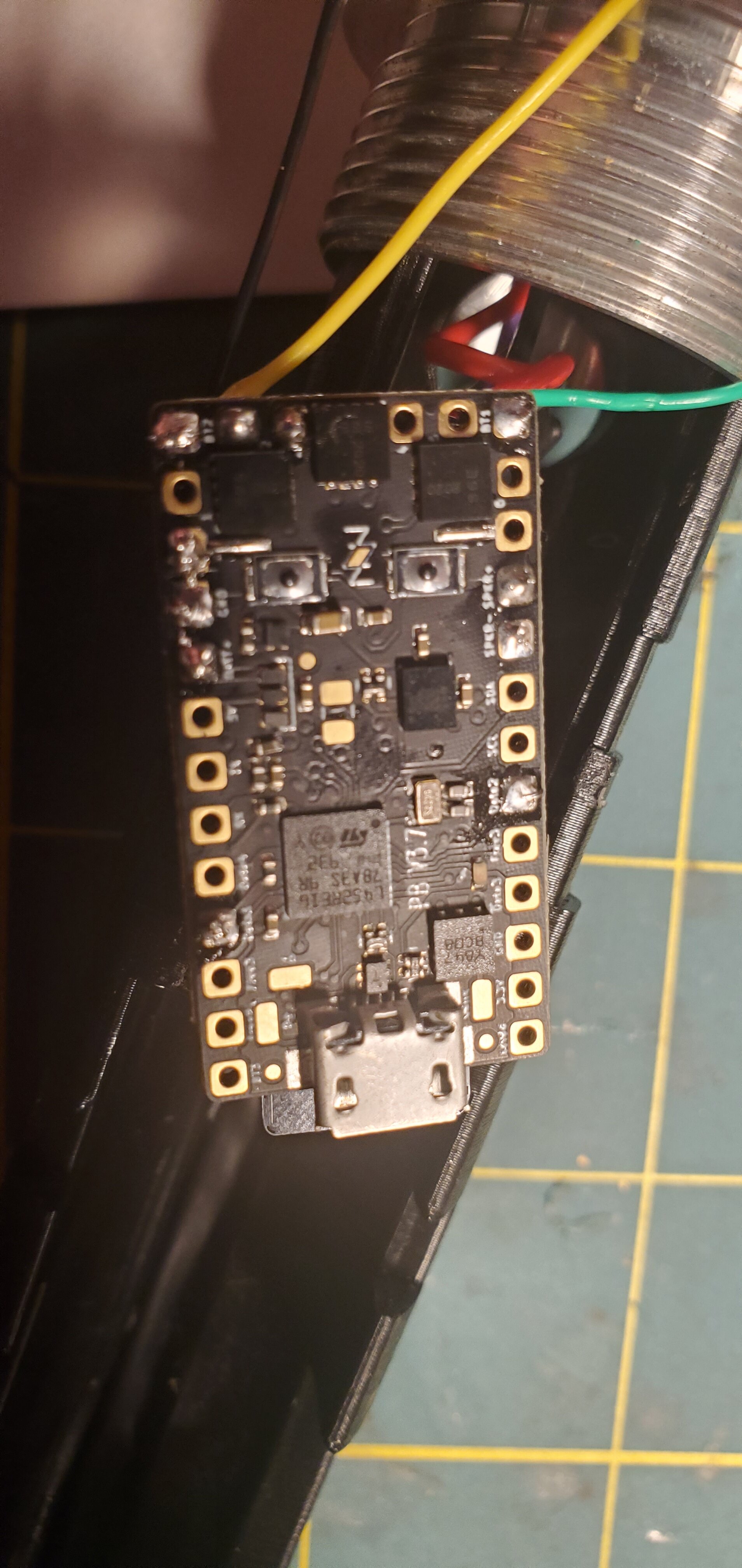

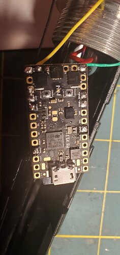

Fredrik said he wanted pics and video of builds. Did mine tonight live! I have some cleaning up to do, but the saber is working. Here:
Board almost installed:
PS, Data 1 and 2 work to drive neopixels as expected. I’ll jump the Shtok pixels over to data 3 and 4 to check them. I missed that in my last beta. Then I think I’ll move onto OLED, and maybe Blue Tooth via Red Bear Nano II BLE.
