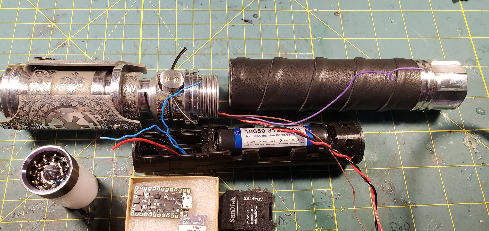

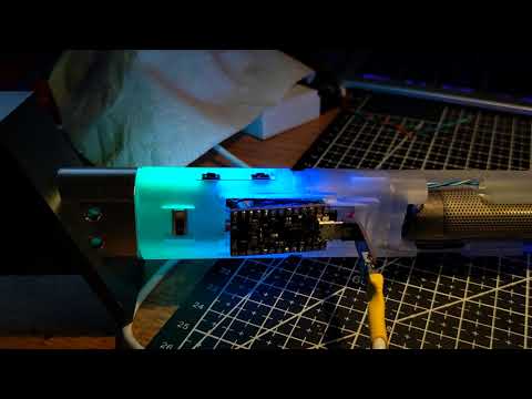

How about the accent neopixels to 3.3v and gnd?
Even if ok, I’m just redoing them proper.
The real question is at what point would LED 2&3 have continuity to all those pads?
It should be fine, but drawing more power from 3.3v may increase the heat slightly.
3.3v is pretty low for a neopixel though, it would be better to run it from battery power.
The continuity is weird, but it’s difficult to know exactly how the meter measures continuity, and when active components, like FETs and CPUs are involved, the results can sometimes be weird, so I wouldn’t worry about it too much.
Copy that, thanks. Rewired to battery and LED 5 instead. Seems all good.
Data 3 pad works, and clear resin is cool :slight_smile:

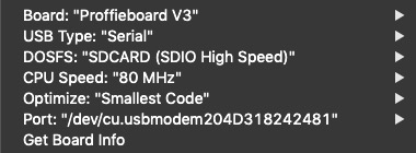

I tried running the default config, but was not able to reproduce the problem.
It could be because my SD card isn’t nearly as fast as the one you have.
If you select “SDIO Default speed” instead of “SDIO High Speed” in Arduino->Tools->DOSFS, does that make any difference?
Second question: The default config file has “RgueCmdr” in two different presets. Does both of them sound bad, or just one of them?
RgueCmdr was the worst sounding. I don’t know which preset or if both.
I will test the 2 scenarios you posted above in a moment, but also TeensySF (one or more presets using that) as well as the others had a hiccup in the out.wav and in.wav for sure.
This was also reproducible when manually changing to a different font with

Ok tests done.
So no difference at all using SDIO Default speed vs High Speed.
Both RgueCmdr presets sound identically skippy/clicky.

I just fresh formatted and tested with a “standard” SanDisk Red/Grey 16GB SD card.
The same fonts behave and sound the same way.

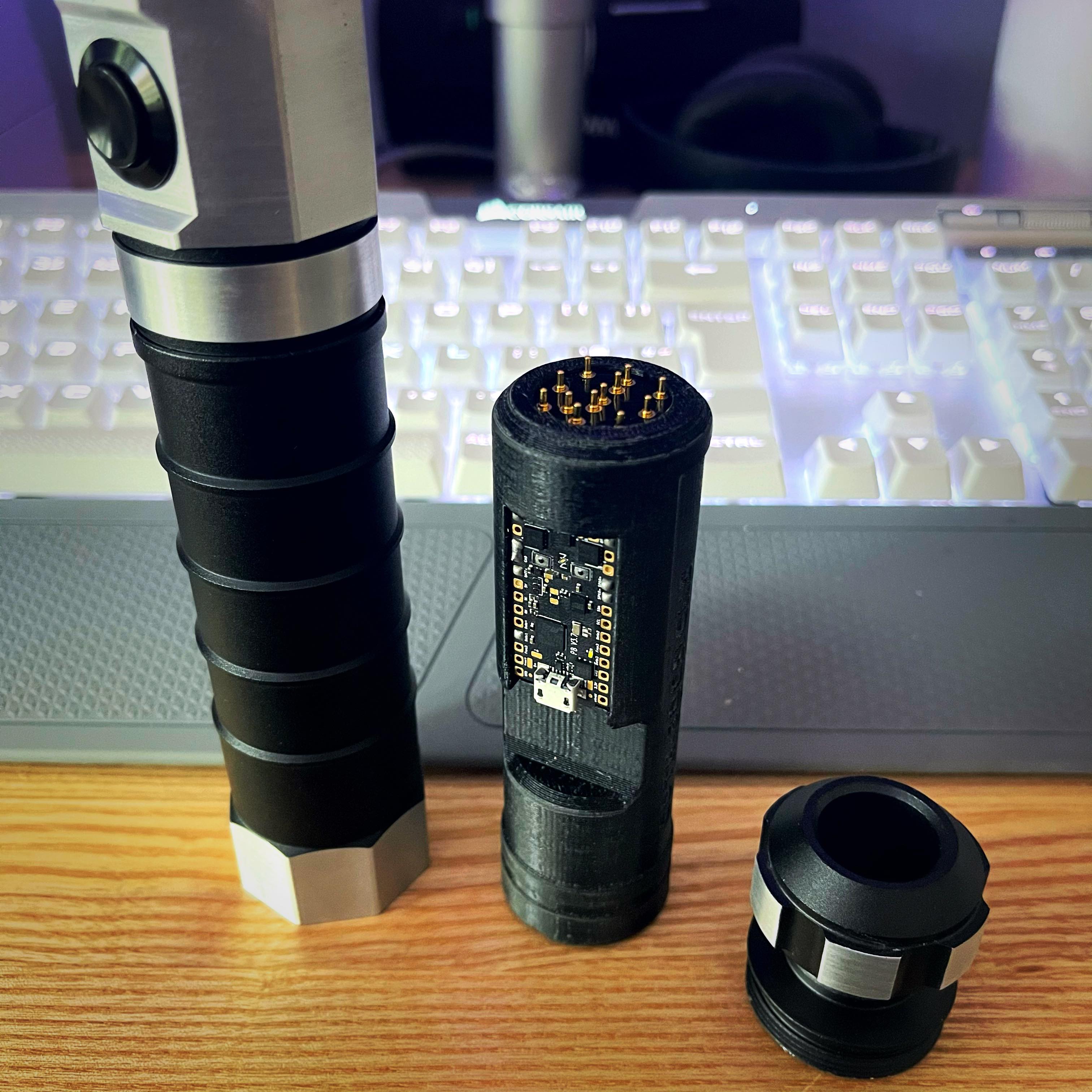

Proffie v3.7 all hooked up! Let’s get tinkering! 31mm speaker too! hehe

  1. Exactly what settings are you using in arduino->tools?
  2. Can you run “top” a couple of times while it’s crackling and paste the results? Maybe I can find a clue there…
Settings:
Screen Shot 2021-06-06 at 7.03.28 PM
