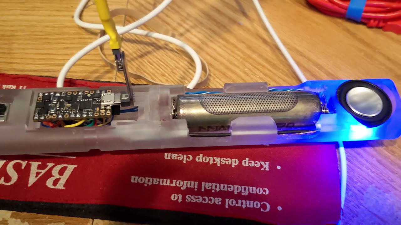

Ok now I’m nervous to turn this thing back on.
I added an accent LED mini pixel strip.
However, I wired the negative to GND, not an LED pad.
As much as I think that’s prob ok, I’m not sure if that caused an issue.
I metered the newly added connections. No beep between any combo of 3.3v, gnd, and data3 (all conveniently in a row).
Turned it on, accent and everything was lit up ok.
But I felt the board was getting warm/hot.
I immediately killed power and USB.
Now here’s the weirdness.
Probing around, I had LED2and3 continuity to like Everything. GND, BATT+, 5v, SDA, SCL. Just beeping on all sorts of other pads.
I opened the emitter to check the back of the PCB, nothing changed there, and all checked out as expected, no shorts.
THEN I went back to 2&3…and all normal now. They beep to nothing else.
Did I catch the FET in some odd state of half-and-half or something?
I swear it was beeping to batt+ and 5v…does not seem good at all. But now it’s not after doing nothing but probing?
I know there’s some sort of signal coming from the multimeter probes…did that close a FET or un-stick it?
Sorry for the run around, I’m just very very hesitant to fire this thing up.
Warm/hot is pretty normal for a V3 board while charging. The charging circuit will generally put out about 360mW. It has a thermal throttle that reduces that if it gets too hot though. Not entirely sure if that is what you are seeing or something else though.
