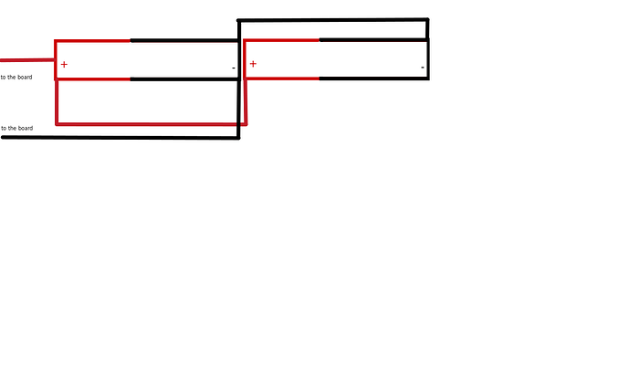

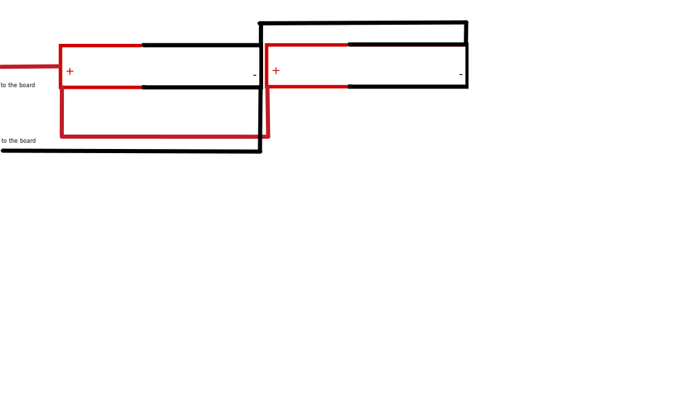

SO I’m thinking that the I should solder the leaftabs so that the tabs 1_____2_3_____4 where 1 and 3 are positive and 2 and 4 are negative and have 1 and 2 are wired to the board, i’m guessing that’s parallel right?
No. Well, i don’t think so. I might be interpreting you incorrectly.
1 and 3 are positive, so they both connect together, as well as the 2 negatives.
this is what I meant.
Yep that’s right.

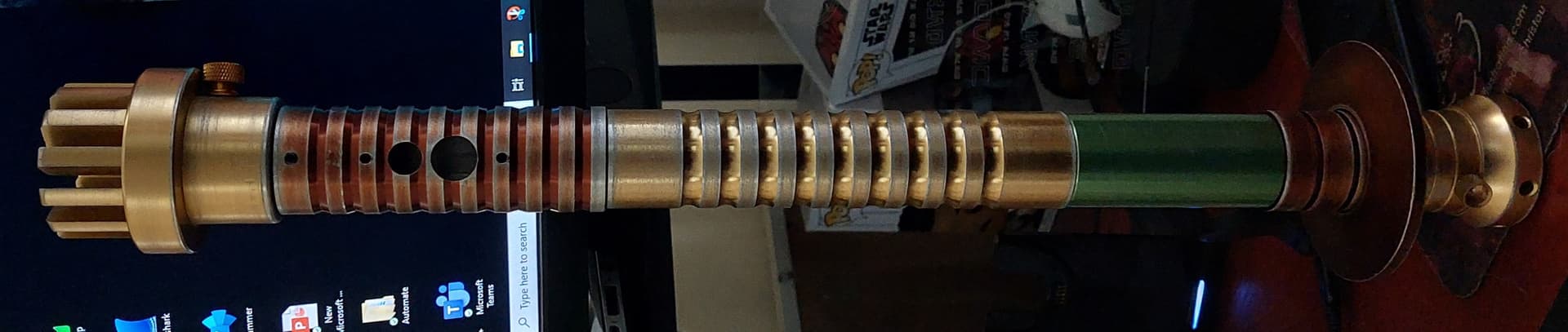

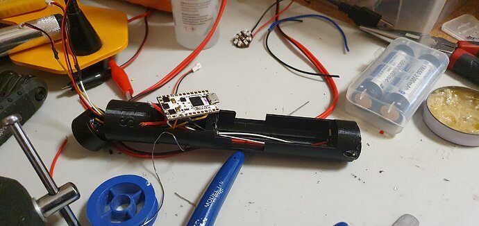

I want to add kill switch to this build but my chassis doesn’t fit one, where would you put it and how would you modify this chassis?
see above but this is the chassis.
@MegtoothSith thoughts on how to modify to add a kill switch? to be answered on your live about to happen for 30th october live
I would guess here.
any tools or methods, I’m trying to avoid using my soldering iron, cleaning the iron is a bitch afterward.
Dremel rotary, drill and files, sharp box cutter and exacto, etc…
Not ideal, that’s for sure.
Why not just make the battery removable?
It is. I like options
But a superfluous option at the risk of a mess / cost of replacing the chassis… worth it still?
sorry max, i just melted a kill switch slot into a chassis tgat lacked one. Pick a slot tgat is co venient, doesnt have obstuctions behind it, and wont mess with hilt.
it’s what I thought, I’ll leave it as is for now, but it would be nice to have a kill switch in a future build.
