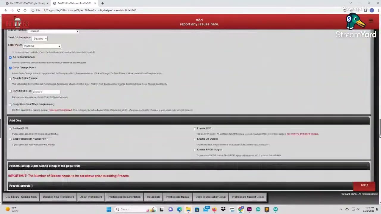

This will be coming to the Config Helper tool as well, more explanation and demo here:

I did notice in your os7 builder when generating the config it removes the quotes from ("65535,0,0 ~ ~ ~ "),
I am still debugging the config tool that was just a demo video of what’s to come :wink:
