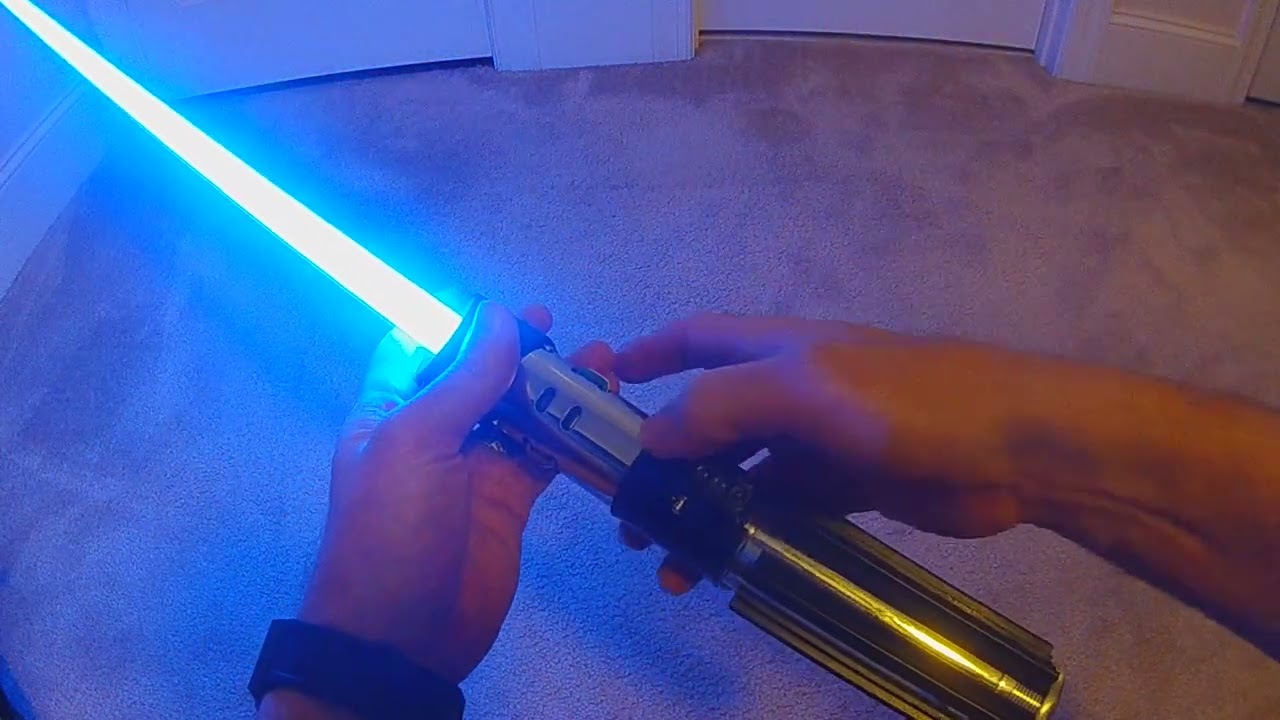

Here’s a POC I threw together. Using a Special Ability slot we are able to use the Transition Sounds to allow for an Idle/Off sound effect, like an engine humming, etc. This effect can be toggled on or off with the Special Ability, giving more control.
In addition, the Special Ability is written to stop the sound when the saber ignites and restart the sound on retraction for as long as the effect is enabled. This allows for independent control of the effect and allows for setting the effect on specific presets where it’s desired without occupying other effects or sounds.
I did encounter a minor bug in my OS7 prop that limits this use so we may need an update to OS7 or may need to wait for OS8 to officially launch, but conceptually this runs perfectly and allows for a very flexible implementation.
Thats the ticket! I shall wait for it!
I have added this to my Early Access Library for OS7.15 (note you will need 7.15 to run as there was a bug in previous versions that prevented this Special Ability from running properly).
[New Special Ability - Toggle Idle / Off Sound Effect - ProffieOS7.15 Early Access Library Update] New Special Ability - Toggle Idle / Off Sound Effect - ProffieOS7.15 Early Access Library Update I have added a new Special Ability to my Early Access Style Library - “Toggle Idle/Off Sound”. This Special Ability allows you to toggle an idle sound on or off (Special Abilities 5 ~ 8). The Idle/Off sound is a sound that can play while your saber is not ignited. This sound can be anything you want, for the demo I used a hum from a different font and lowered the volume in Audacity. When toggled on the Idle sound will play anytime your saber is retracted and will stop when you ignite the saber. If you want to stop the sound you just do the same Special Ability to toggle off. This Special Ability will require OS7.15 (released a little while ago). There was a bug in previous versions that didn’t allow this type of Special Ability to run properly. In addition to the Idle/Off Sound, there are several other new styles and effects added to the Early Access library that I haven’t had a chance to video yet. I’ve been working on development and testing for OS8 but still have more coming to the OS7 Library as I get time, so keep an eye out. In the meantime, check out the new Special Ability and other additions in my Early Access Library, enjoy!
