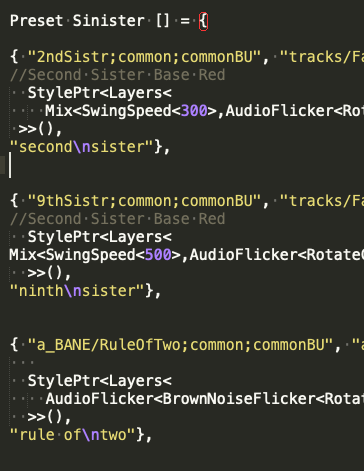

Take a look at this image:
Every preset should be formatted like this, and then inside another set of brackets for the “preset array”
Your last (two) config are missing the brackets around the preset (though the brackets around all the presets are present)
Note that the name is recommended, but optional

Because you added Jumpbike, but missed the opening preset brace {
You have it starting
"JUMPBIKE;common".........
it should start like this
{ "JUMPBIKE;common".........
Your ending is correct
.........1000,3>>,EFFECT_PREON>>>(), "JUMPBIKE"},
Although i highly suggest you format all of your presets the same so it’s easy to see these things.
For example, Binary Dark, your first preset starts and ends like this
{ "Binary Dark;common", "tracks/mars.wav", //1--
StylePtr<Layers<...........
>>(), "binary dark"},
The opening brace { and the first 2 arguments StylePtr<Layers<
have their closing brackets on the last line along with the name and the closing brace.
Make all of your presets the same.
Also, if you’re not using a code-friendly text editor, things are much harder to see.
Use SublimeText.
Look how I have one of my configs for example:
