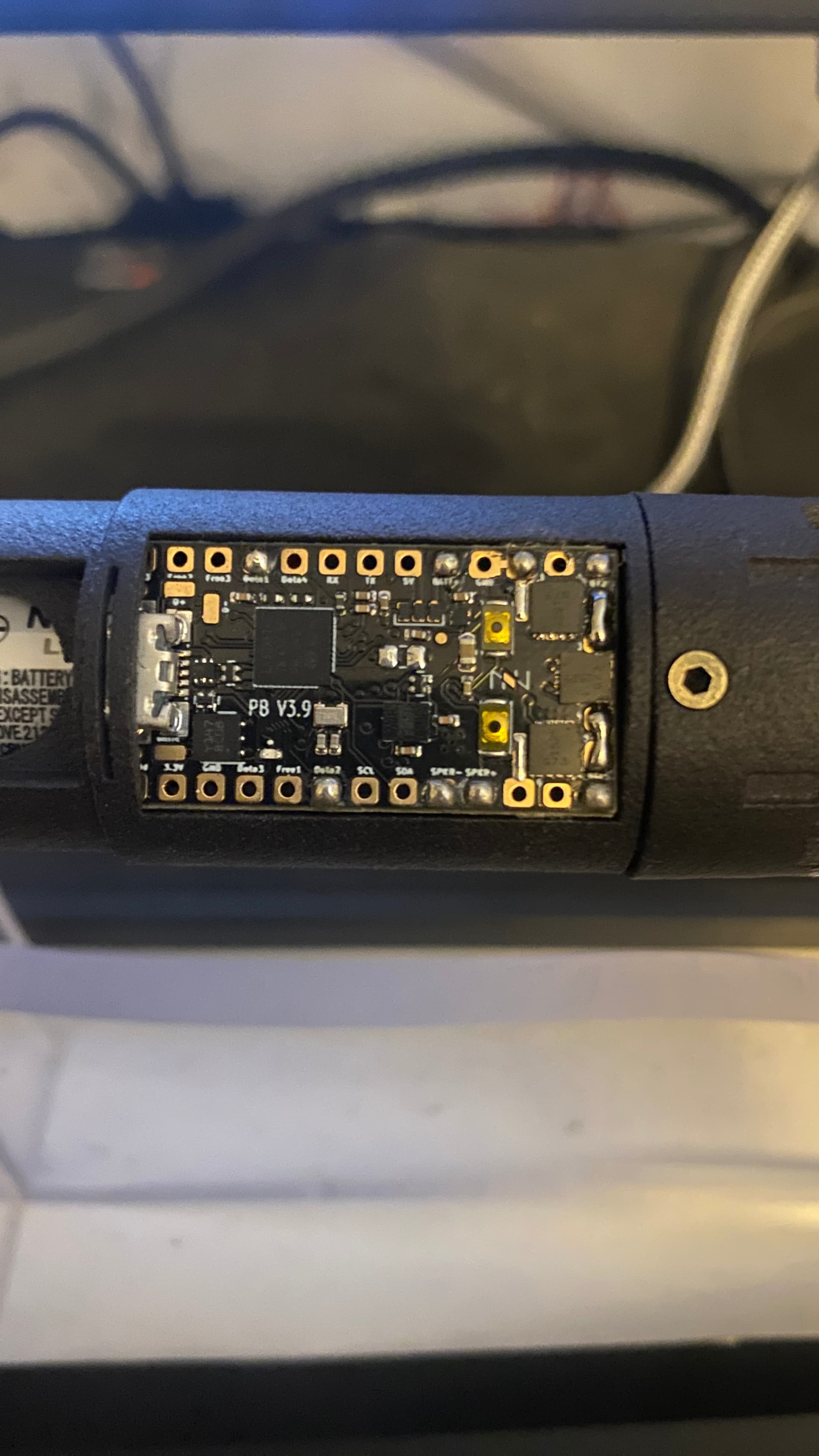

looking in proffie docs these defines are in the sub blades section so now i am really confused.
the blade config is not writen for sub blades
  { 0, WS281XBladePtr<128, bladePin, Color8::GRB, PowerPINS<bladePowerPin2, bladePowerPin3> >(),
    WS281XBladePtr<26, blade2Pin, Color8::GRB, PowerPINS<bladePowerPin1> >(),
    WS281XBladePtr<26, blade3Pin, Color8::GRB, PowerPINS<bladePowerPin4> >()
  , CONFIGARRAY(presets) },

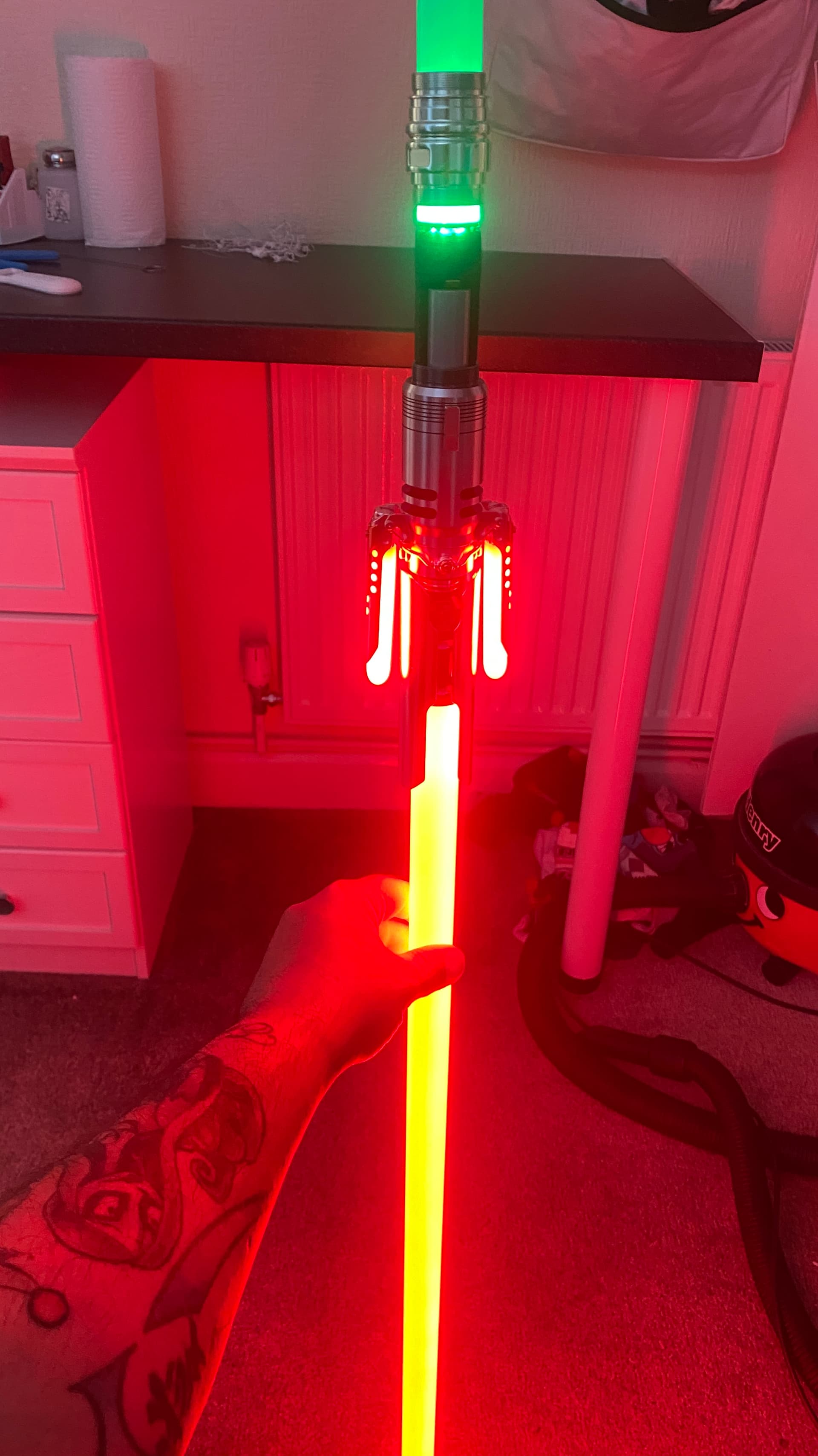

the saber is setup with 3 blades but only 2 seem to do anything, i set my first preset up to identify the blades and the 3rd blade seems to be absent
style 1 = main blade + connector led pcb + side blades
style 2 = led pcb (not connector}
style 3 ???
is there any way i could set the side blades to run independent from the main blade,
i am way out of depth with is and any help would be much appreciated, thank you

That depends on how they are wired.
If they are wired in parallel, then there is no way.

im not to sure how its wires to honest, how come its got 3 blades in the config if it only uses 2 that doesn’t make sense, looking at the board only data 1 and 2 seem to be used

Have your tried 3 simple styles: one blue, one red and one green ?
Edit: Oops, yes you did, sorry.
In this config, each quillion is controlled independently, thus three blades.
im sorry but i dont know what that even means.
so if there is 3 how come i cant separate the side blades from the main blade?
did i remove something from my updated config
sorry for being a pain, i jut don’t understand why there is a 3rd blade and why i cant delay the side blades
You need separate wires going from the board to each thing you want to control individually.
You don’t seem to have that. Thus, the same signals are going to the blade and the side blades (quillions).
Does that make this useless? It must do because it’s not doing anything when I change the values.

You can either:
  • change the wiring (add wire(s) for the side blade(s)) or
  • delete the style lines that didn’t turn blue in your test and change NUM_BLADES to 2 and delete the blade entry that didn’t turn blue but you will not be able to have independent behavior for your side blades.
Without more wire(s), yes it is useless.
Edit: I think
Why would they put it in the config then if it doesn’t work, that’s just a tease, bloody Chinese configs
Because it is easier for them to write one config that will work on a two and three blade saber, rather than teach the Chinese “saber builder” how to choose and read witch config goes on which saber. (it could be dangerous for the bosses if the poor guy who build your saber would learn to read a foreign language)
If I was to try and lift the board up to get a peak at the wires would a single wire coming from data pin1 indicate that its wired in series,
Would changing the blade config to a sub blade configuration damage the board anyway if it is wires in parallel?
no
It’s likely spliced at the other end.
No, but what would be the point?
You would already knew if everything was wired in serial, because if they were, you would notice a small delay between the ignition of blades.
I wasn’t aware that you’d noticed a delay unless you created the delay, seems obvious now that it is wired in parallel making them define to delay useless, would it be worth deleting then out of the config if they’re doing nothing? Also might as well get rid of the third blade style as well if that’s just doing nothing and change the blades to 2 what do you reckon?
Unless you want to do some soldering, that seems reasonable.
