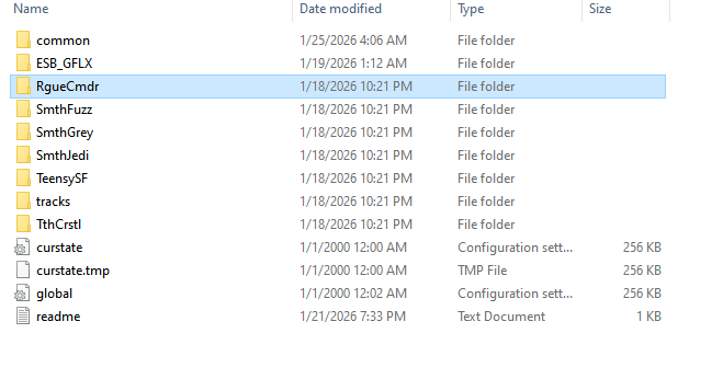

This is what is on the SD card
explorer_XPc925HhZI
and current config uploaded to the board

Thank you I will get to changing that later tonight. And yes I do have voice pack inside the common folder. I just took the contents of the folder downloaded and dragged them into the SD card. Actually tried to download it again to see if I missed anything on accident

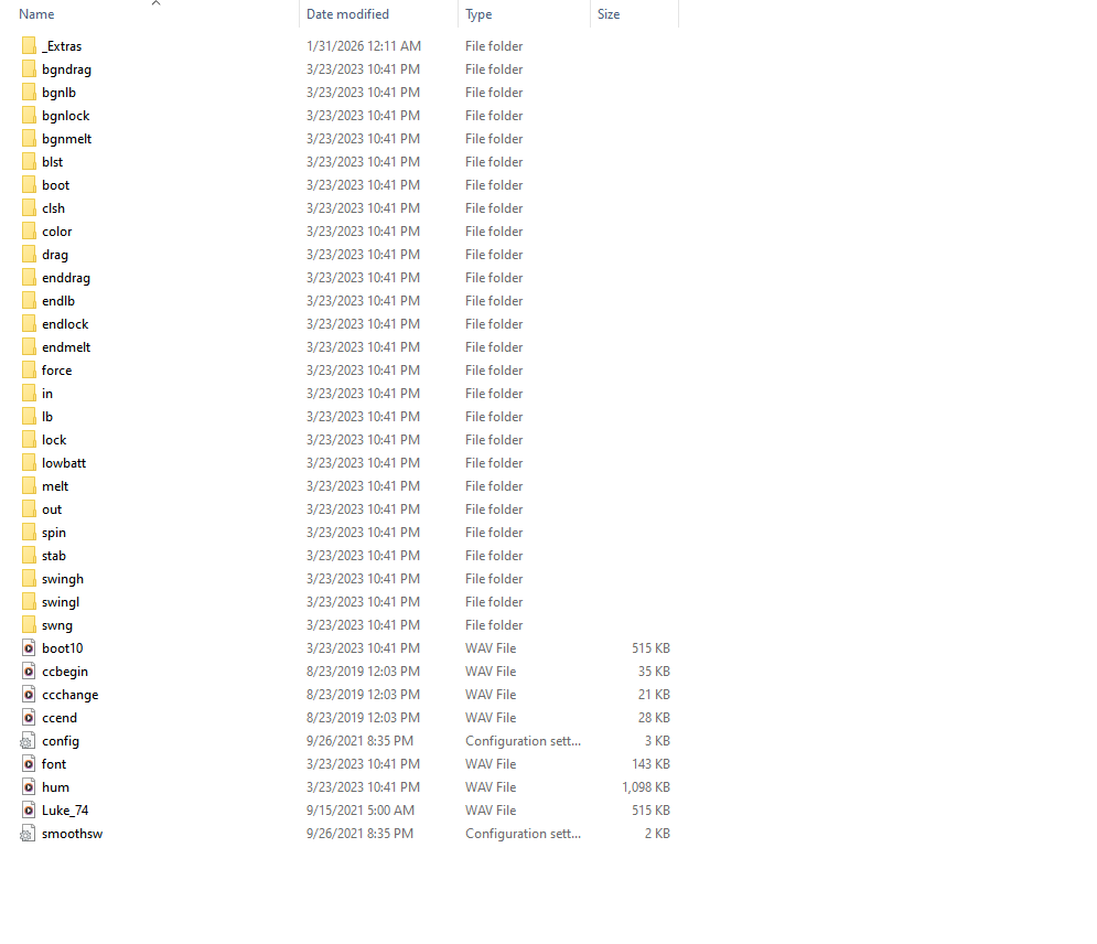

It contains everything that is included in the profile subfolder of the ESB Graflex font that is from Kyberphonic. I am not on my computer right now, but I can take a screenshot of the folder contents later tonight

On line 8 it says no sounds found, So I am including a screenshot of what is within the ESB_GFLX track subfolder. Don’t know if anything in there is missing
I think you need a font.wav but I also see you do have one in your folder ? Maybe it is in the wrong format.
You can try and rename your font.wav to font_bad.wav and rename your Luke_74.wav to font.wav and see if that helps.
Didn’t work unfortunately :pensive:
Then you might have a bad format for your font.wav and Luke_47.wav
