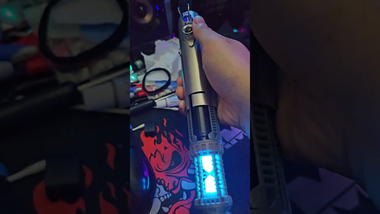

Can you maybe record a video, upload to YT or google photos and then post here?

For the video do you just want to see it being turned on and ignited?

Mostly I want to hear the error.

This is the video. It is just me turning on the saber and igniting it with what happens when I try to cycle presets.
