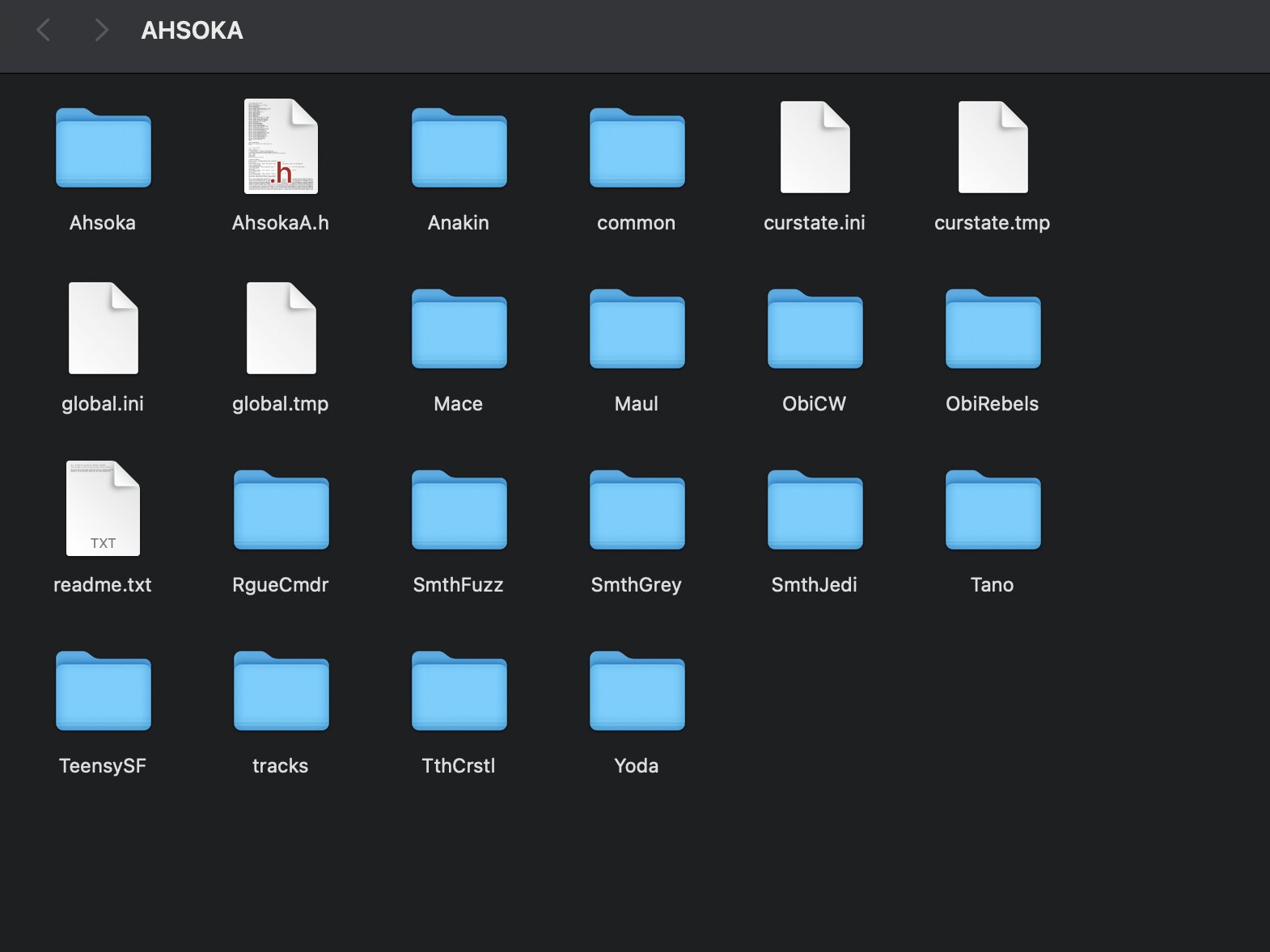

Hello everyone, I have a head scratcher of a situation… So I bought a pair of Ahsoka Tano /Snipx V2 lightsabers from the Pachstore… I have finally figured out how to properly update, and add numerous effects + so much more cool stuff onto my Proffie soundboard v2.2. And ontop of that I have added various fonts to BOTH the Shoto (Short) and my Shein (Long) saber hilts. For some reason ALL Fonts work 100% properly on my Shoto hilt, while my Shein hilt has that dreadful “Font directory not found” that plays on the speaker when I scroll through my fonts… out of the 8 fonts I’ve installed 3 of them do not work on my Shein hilt which includes the: Tano, Maul, Anakin. I literally copied and pasted the folders over to the Shein hilt’s SD card and have made ZERO config changes in my ProffieOS Config file… SO I’m not sure why I keep getting that directory error. CAN someone PLEASE help me as I am so confused as to why this is even an issue.

I also gotta add one thing regardin the “common” folder… Yes I have a “common” folder in both my SD cards for each hilt… but I’ll be honest I’m a bit confused by it’s purpose. My “common” folders are currently empty with no other files or folders within it. I only added that folder because I was told to per Fett263’s instructions. But I have read that part about the “common” folder again and again and have still not figured out it’s purpose or what needs to be put inside of if. I couldn’t find a photo or a video attached to it so I have no clue what to do more than have a folder called “common” I just ran with it being empty cause it hasn’t given me any issues yet haha.

Ok I went with the Ahsoka one and have downloaded it and placed that “Common” folder into both my SD cards. Am I only allowed to have one voicepack at a time? or how does these work?
Don’t look further, your problem is the empty common folder. I am actually surprised that only one saber is giving you that error?
You can only have one common folder. If you want more voicepacks, you can copy the content of “Maul common” in your “Maul folder”, the content of “Anakin common” in your “Anakin folder”, … ProffieOS will first look for the files in your font folder, if they are not there then it will look in your common.
