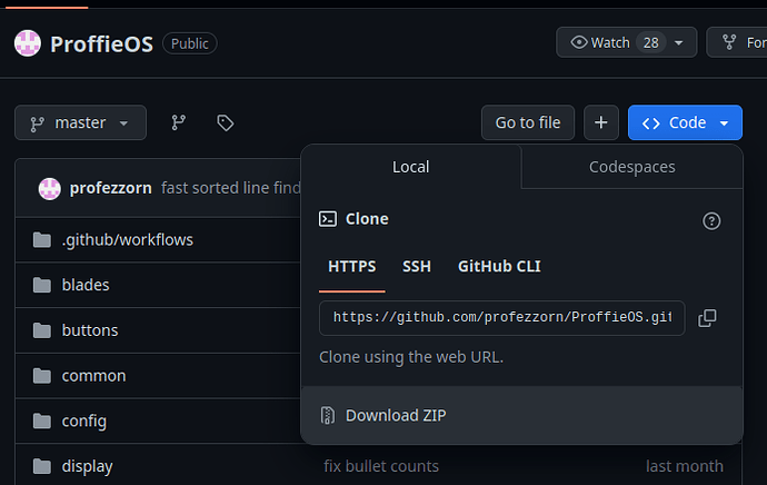

No, he means to download the source from the github directly, which is newer than version 7.14.
You’d click “Download ZIP” from right here:
