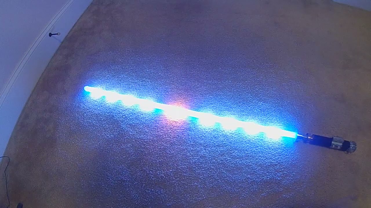

Happy Holidays! Per a special request from a young saber fan I have added multiple new Holiday Styles to the OS6 library.
Christmas Tree - Updated for OS6 with more options This style replicates a Christmas tree with a pulsing star top and blinking lights throughout. The base has a gradient effect that allows you to lean your saber against a light colored wall to create a tree-shaped aura.
Candy Cane - I have multiple candy cane options including an Inertia Swing version that moves based on the inertia you generate and then settles back to static.
String Lights - I have added multiple blinking and pulsing “String Light” options to replicate a string of holiday lights for fun.

Much appreciated! She loves it and so does her brother. I just need to hang the string lights up on her new doll-shelf now that I made the blade plug connector/adapter.

Here you go :wink:
Continuing the Holiday Theme, here is a new Hanukkah Menorah blade style for Proffieboard. There are several Interactive control options as well as a right-handed and left-handed version to allow the “candles” to be lit from Right to Left in order. Each Interactive step will light a “candle” on the Menorah.
  • Interactive Force Effect will light each candle one-at-a-time each time you do your Force Effect
  • Interactive Clash Effect will light each candle each time you do a Clash
  • Interactive Swing Effect will light each candle each time you swing the saber
    The “candles” will remain lit as long as the preset is active, cutting power or changing presets will reset.
    There are two versions to allow the Menorah to be lit from Right to Left
  • Right-Handed (lights from hilt to tip in order)
  • Left-Handed (lights from tip to hilt in order)
The style code is available in the Holiday Styles section of the OS6 Library.
