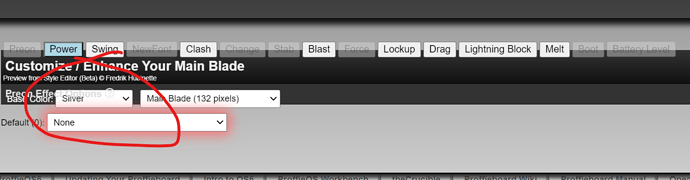

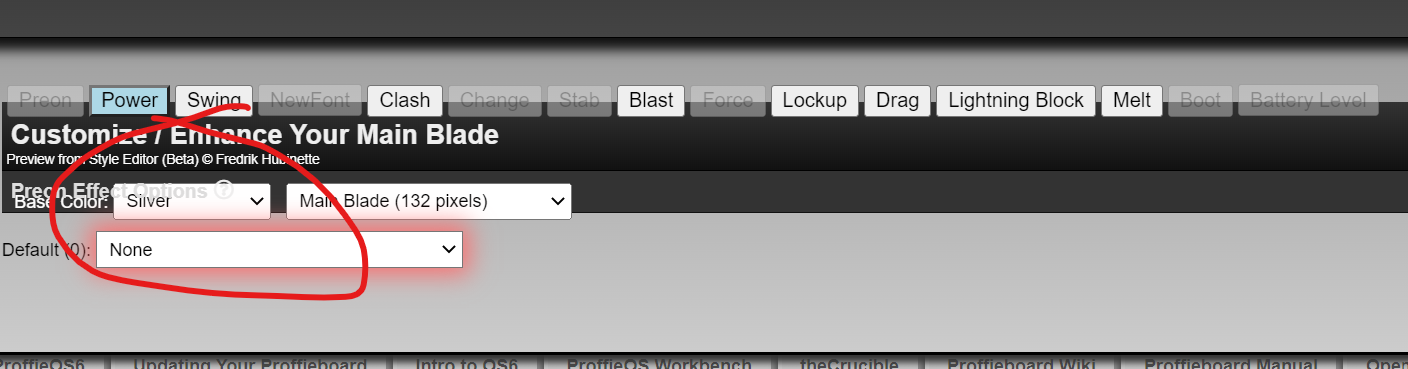

I’m having issues with the library, particularly with changing the color in the preview/enhancements screen. Changes color in the viewer, but reverts back to silver in the code. Anyone else having issues?
NOTE: Only seems to be an issue with the Darksaber blade.

I have fixed both issues, you’ll need to refresh page for update.
