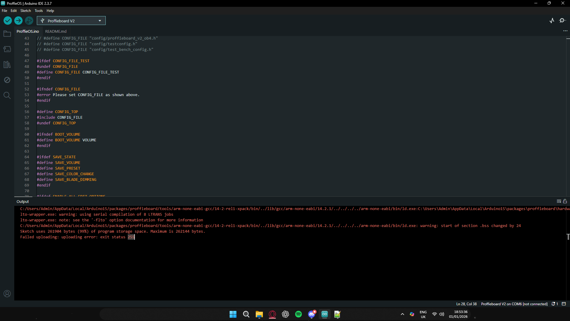

i keep getting this error
alright as of recently ive gotten THIS new error message.

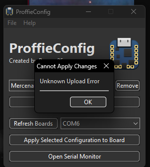

ive also tried to use proffie config which showed me this
forgot to send the image ffs

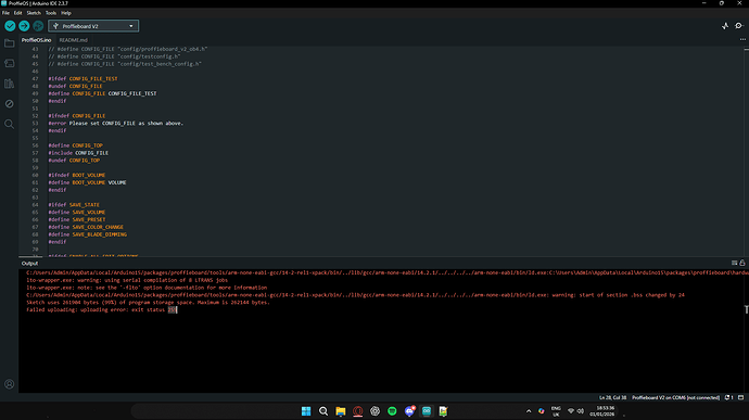

this is the one im using. i also keep getting this error as of now.

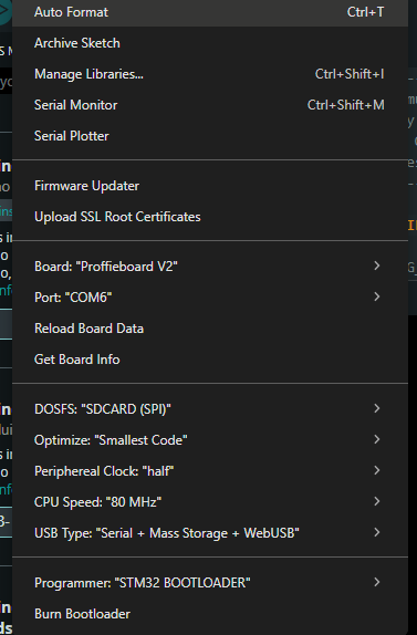

Invalid FQBN: getting build properties for board proffieboard:stm32l4:ProffieboardV2-L433CC: invalid option ‘pclk’
Compilation error: Invalid FQBN: getting build properties for board proffieboard:stm32l4:ProffieboardV2-L433CC: invalid option ‘pclk’
I just checked it on my end and it compiled fine for me, it seems to me that you may have the wrong board selected. Do you have Proffieboard V2 selected or Butterfly-L433CC?

Can you show me in the arduino sketch where you are addressing the config?
error 255.txt (43.4 KB)
heres a txt file for it
You may be right about it being a hardware issue because everything software wise seems fine.
