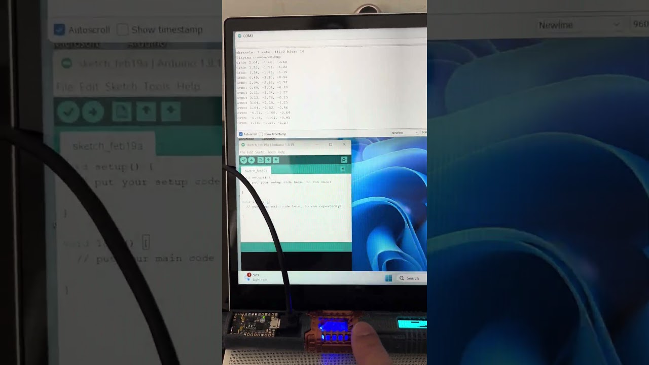

Here you go. This is with CLASH_THRESHOLD_G set to 0.5. In these logs you can see that before Turning the saber ON I am easily triggering Clash events with little movement. Then after IGNITION you see it takes much more movement to trigger Clash. All of those “swings” you see after IGNITION is me trying to trigger Clash.
