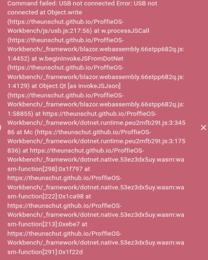

sorry to do this to ya @cryptic96 but the tool has tendency to time out and when that happens all my presets go missing. e.g.
I had 22 presets, and My original config had 7 presets plus there was a some errors but I can’t copy those to post here.
this is the timeout error I get.
thanks! that’s a start i could work with. I’ll try to look into this when i have the chance!

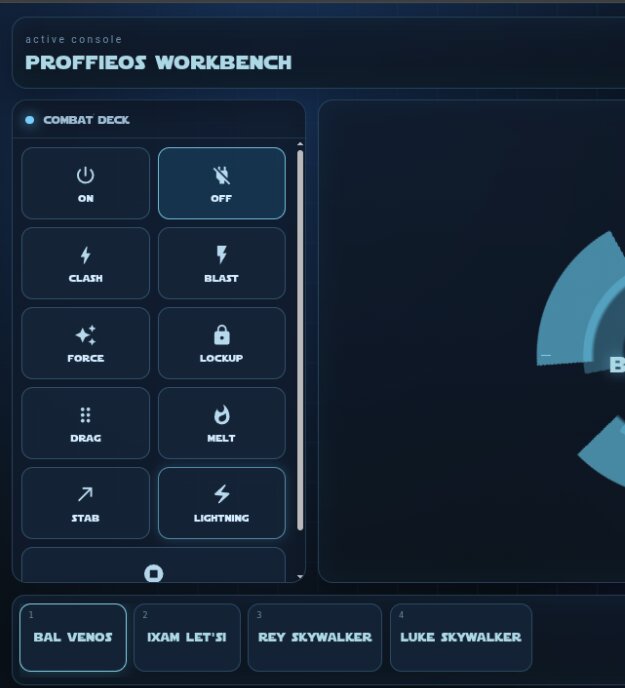

with the time out and missing presets I removed the #define save state thinking that might be causing issues. but the usb timed out again and I’m seeing the same behaviour where the first 3 presets are the only ones that are present and the rest are all missing. I don’t have another cable but could it be the docking station on the steam deck? I think I can test it on my sons linux desktop.
I already started an investigation, but i havent gotten far.
The connection issues could just because I rewrote the app from JavaScript to .NET. But I’m working on it where I can. I’ll update when I know more

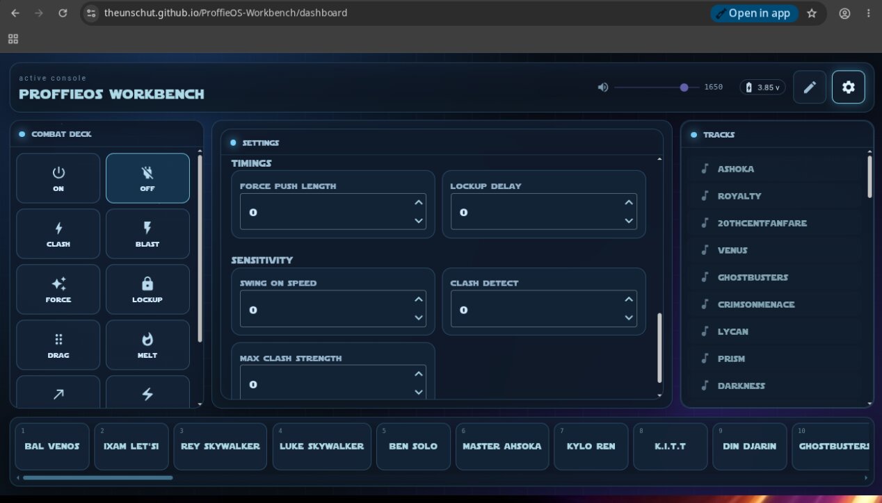

so I have been having some inconsistent results. when I click on the “+” and add a few soundfonts using existing soundfonts it has a tendency of becoming unresponsive. now, I am using my steamdeck to do this cause it could either be a memory or cpu bottlenecked but I thought I’d raise it here first.
I was also wondering with the Font field it has fontname;common
is there any way we can scan for common folder within the folder? e.g. fontname;fontname/common?
